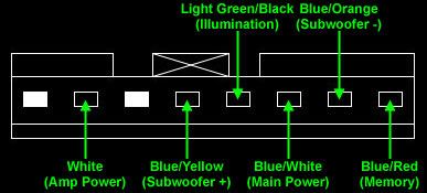

Find the white wire on the main radio connector. Be sure it's the main connector from the radio and not the speaker connector.

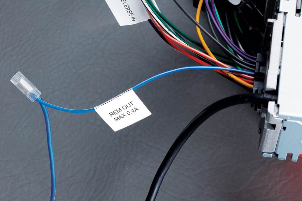

Connect the white wire to the new stereo unit's amplifier trigger wire. Usually blue wire, could be labelled as remote wire.
