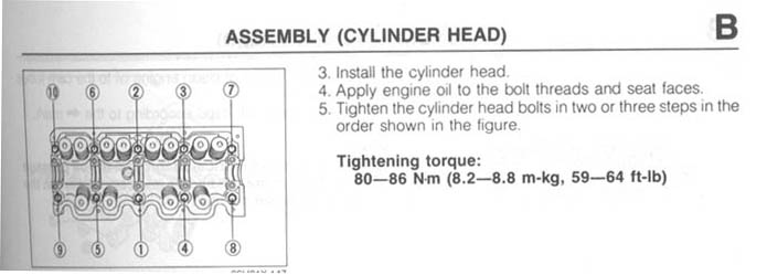

89-92 F2-F2T Cylinder head torque specs & tightening sequence
Posts: 197
Post by 1stgenWizard » Mon Sep 14, 2020 1:35 am
