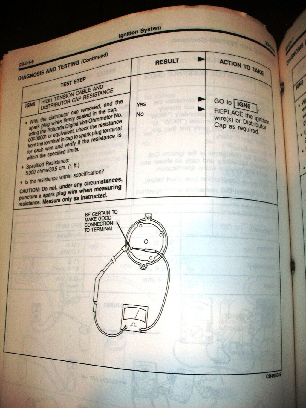

Spark plug wire and distributor cap resistance testing GT, non gt similar
Tests
Posts: 197
Post by 1stgenWizard » Mon Sep 14, 2020 2:06 am
