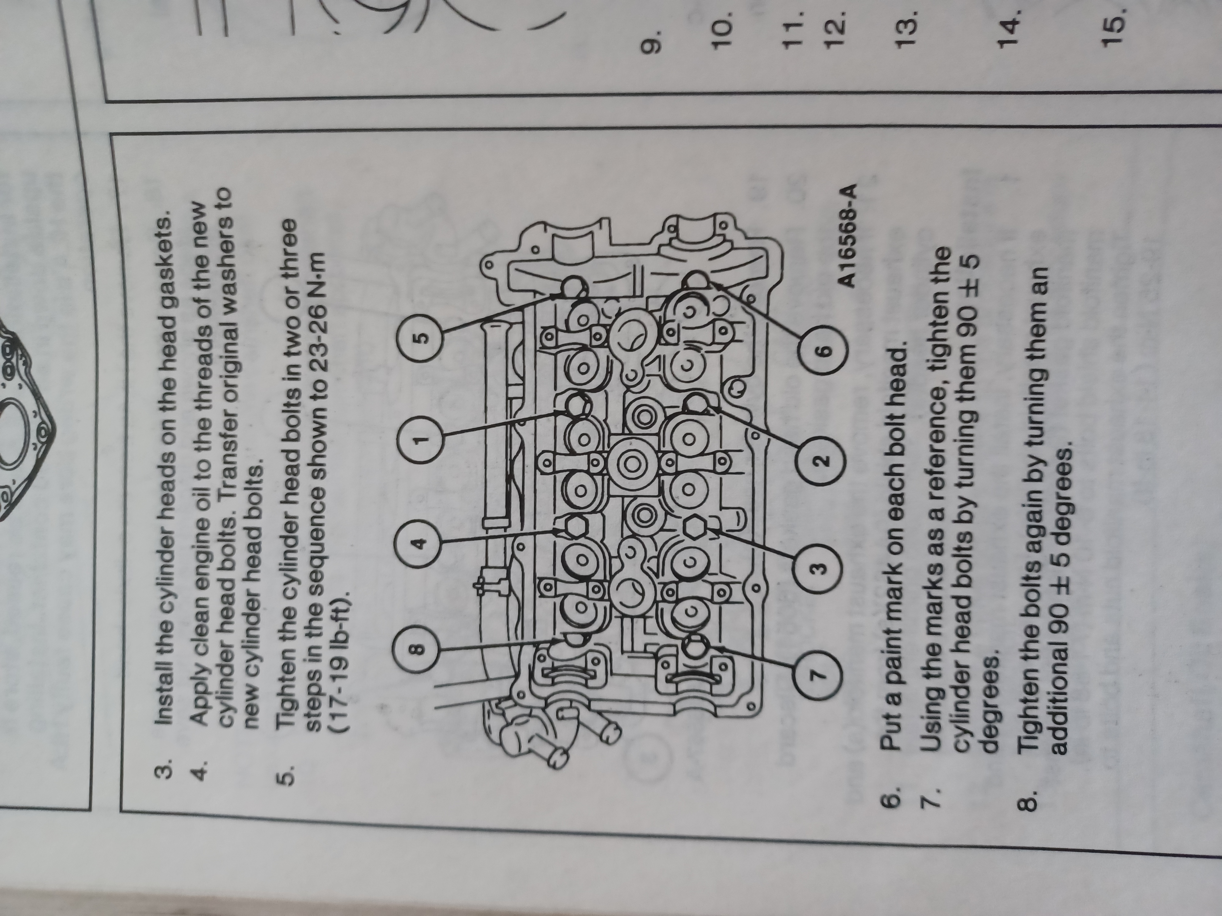

2.5 Liter V6 cylinder head torque and tightening sequence
Specifications
Posts: 197
  • Report this post
Post by 1stgenWizard » Sun Mar 10, 2024 2:13 pm
:arrow: :arrow:
