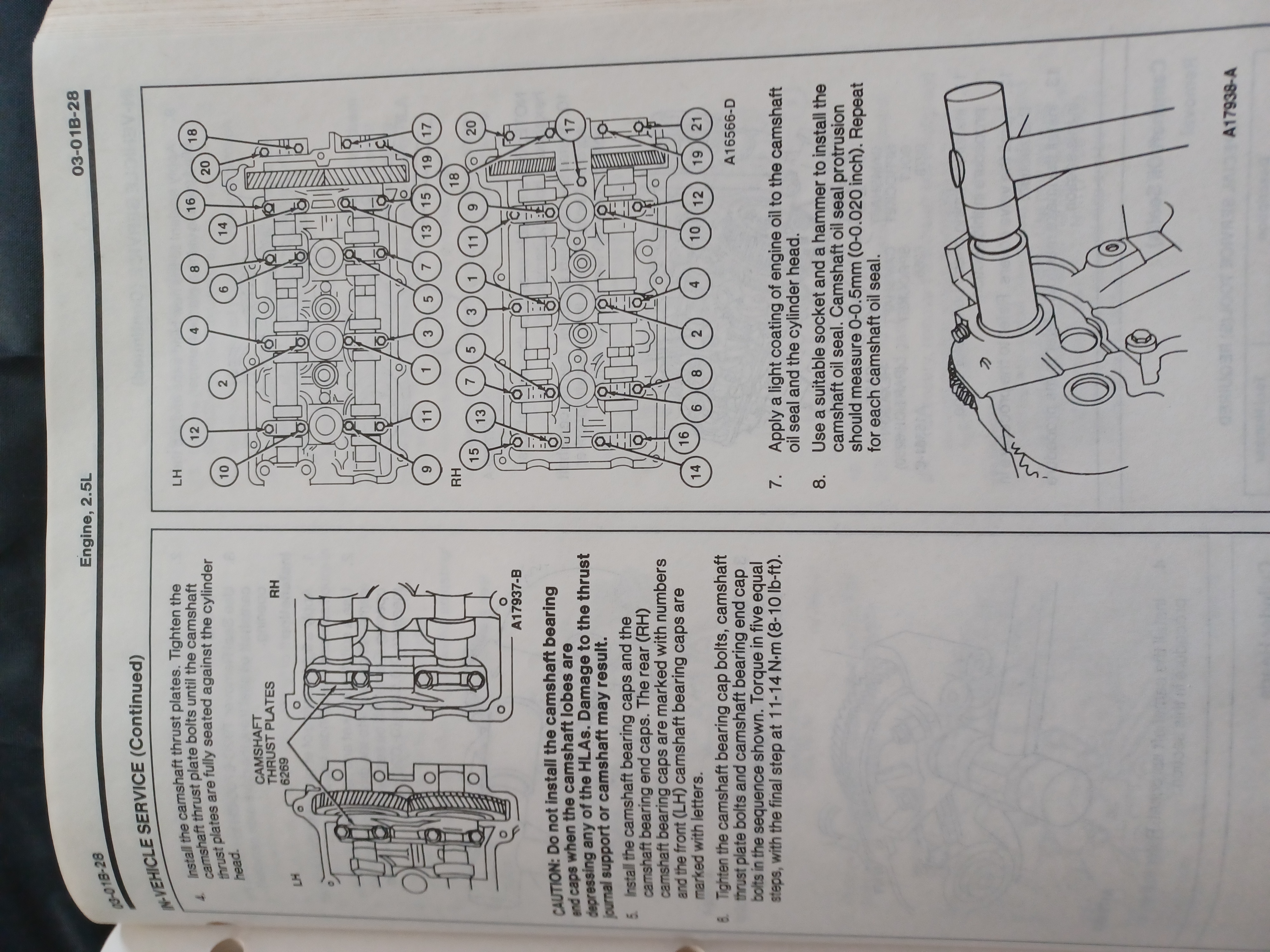

2.5 Liter V6 cam shaft cap torque and tightening sequence
  • Report this post
Post by 1stgenWizard » Sun Mar 10, 2024 2:12 pm
:arrow: :arrow:
