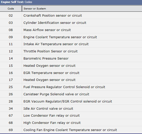

Interpreting the CodesThe pulses on the voltmeter and the flashes on the Malfunction Indicator light translate into multi-digit codes. To simplify things, we'll call all flashes and pulses, pulses. There are two types of pulses. A long pulse is a pulse that lasts 1-1/2 seconds. A short pulse is a pulse that lasts a 1/2 second. These are pretty distinguishable. The long pulse represents the first digit, and the short pulse represents the second digit. So, if there are three long pulses followed by four short pulses, that would be the number 34. If there isn't any long pulse, the number is less than ten. Eight short pulses with no long pulse would be an 8 code. If there is a long pulse, but no short pulse, the code is 10. If there is more than one code, each code will be separated by a 4-second pause. When all the codes are displayed, the codes will repeat.
Example; Codes 8 and 34
