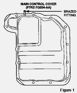

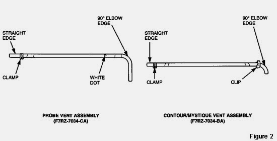

NOTE: BEGINNING JANUARY 1997, ALL CD4E TRANSAXLES CONTAIN A REVISED MAIN CONTROL COVER (F7RZ-7G004-AA), FIGURE 1, AND VENT TUBE ASSEMBLY (F7RZ-7034-CA FOR PROBE AND F7RZ-7034-BA FOR CONTOUR/MYSTIQUE), FIGURE 2. THIS NEW DESIGN WILL PREVENT FLUID FROM SEEPING FROM THE VENT. IF THE VENT HOSE IS KINKED OR BLOCKED INTERNALLY, FLUID WILL LEAK FROM THE TRANSAXLE FILL TUBE.

Fully seat straight end of tube onto brazed fitting on main control cover. Mount clamp securely onto brazed fitting to secure tube assembly (Figure 3).
Route tube assembly toward rear of vehicle.
NOTE: BE SURE 90 DEGREE ELBOW IS FACING DOWNWARD.
Install tube assembly on air cleaner housing and align white dot with retaining bracket closest to front of vehicle. Insert 90 degree elbow end of tube assembly into air cleaner clamp. Allow approximately 25mm (1") of free tube (Figure 4).
Route tube assembly upward toward the rear of the battery (Figure 5).
Attach clip to battery hold-down bracket bolt (Figure 6).
Be sure 90 degree tube end is routed downward (Figure 7).
