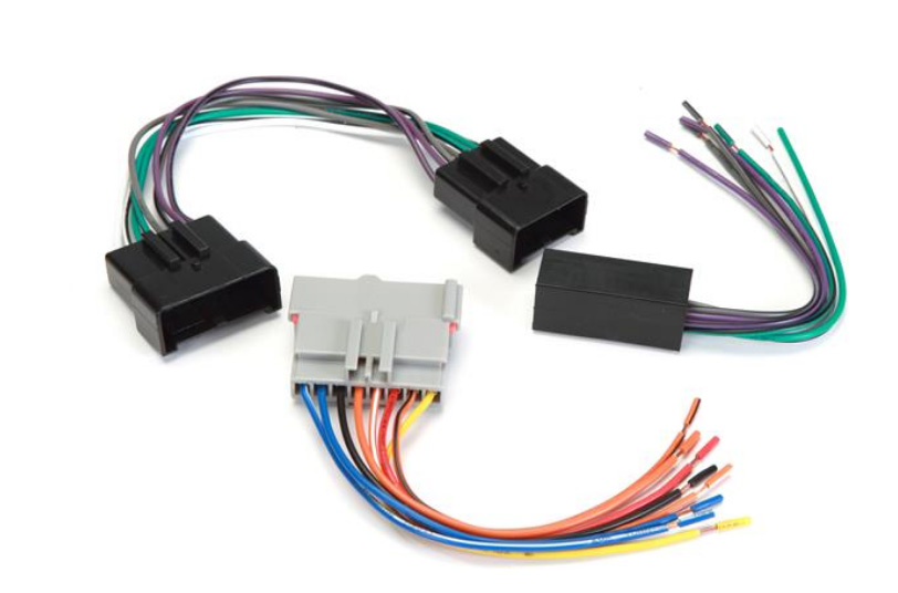

Metra 99-5512 Dash Kit Stereo Installation Kit 1993-1997 Ford Probe
Metra 70-5510 connector wiring kit
or Metra 70-5514 (which includes factory amp bypass harness)

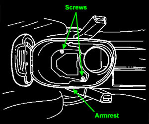

If equipped with a center armrest/storage compartment, open the armrest and remove the two screws at the bottom of the storage compartment. Remove the armrest cover.

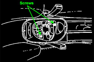

Remove the two screws at the bottom of the storage compartment base and remove the storage compartment from the vehicle.

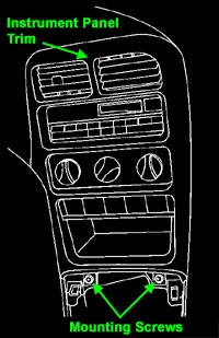

Remove the two mounting screws on the bottom holding the instrument panel trim in place. Pry the panel straight off and disconnect any wires (if any are present) from the rear of the panel.

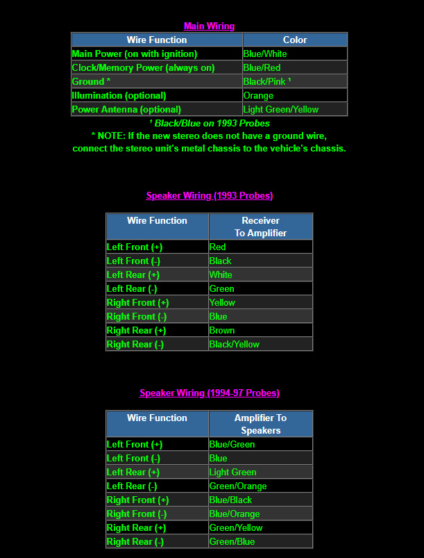

Use wiring Metra kit to wire in your new stereo, I recommend soldering the wires and using shrink tubing to cover the connections.
Use this wiring table for reference on the wiring connections.
