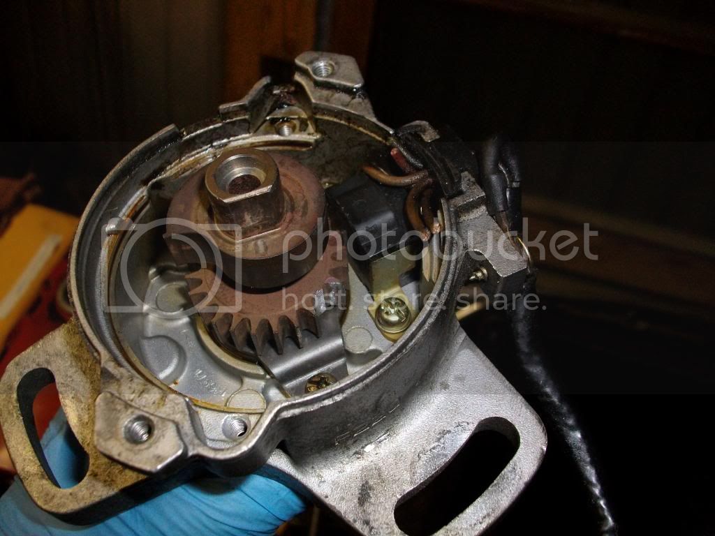

To start the modifications, remove the cap, rotor, and protective cap.

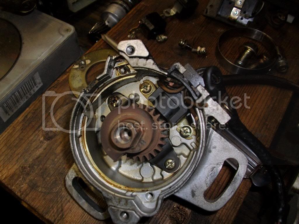

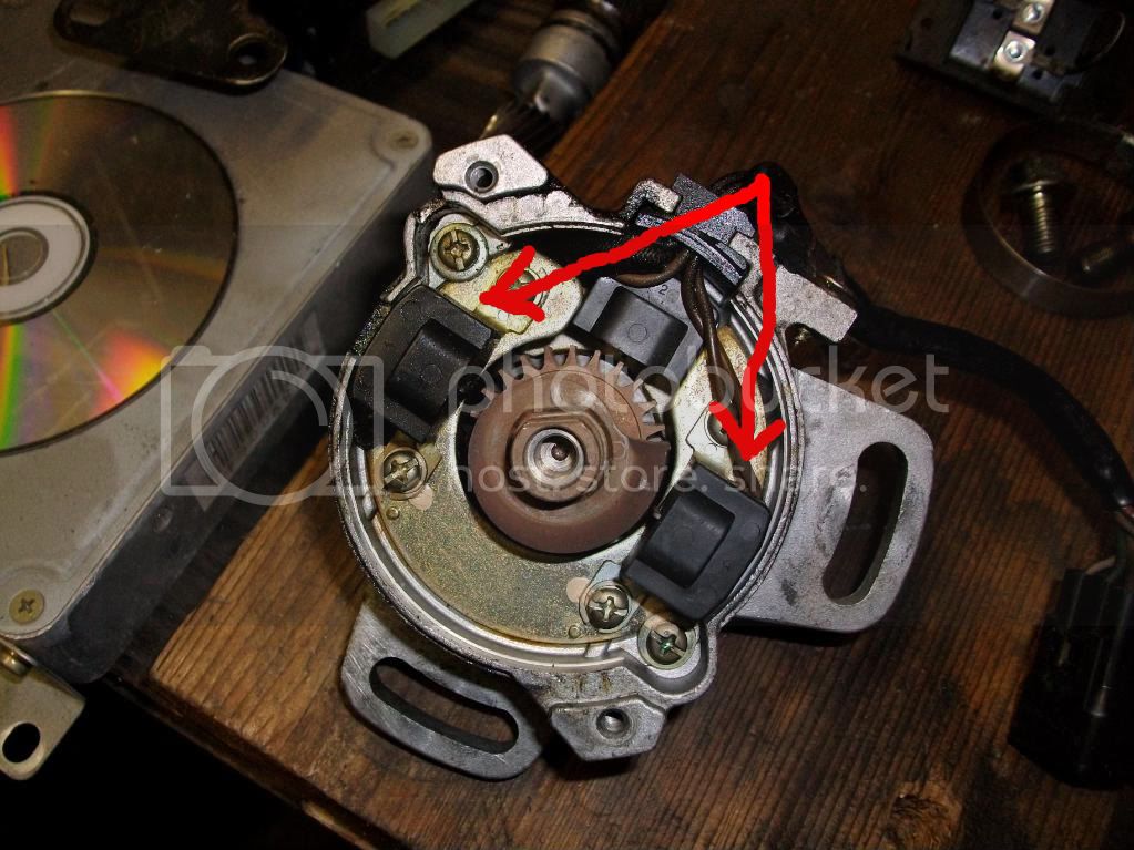

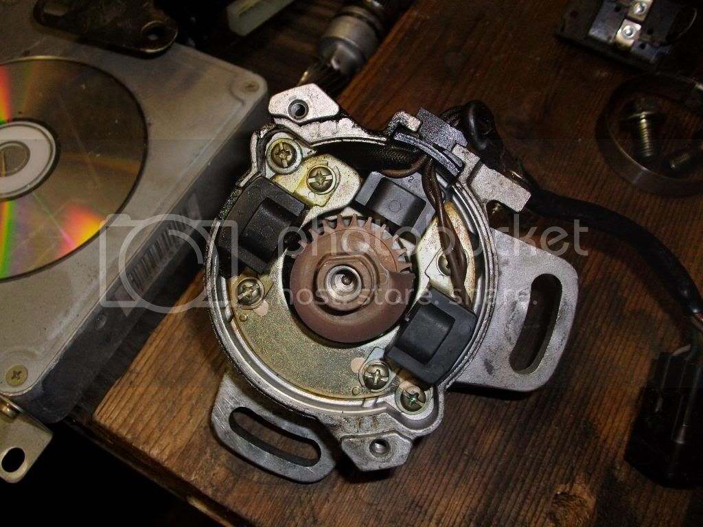

Remove the two sensors on top by first removing the 4 phillips screws (2 per sensor). Then cut the wires attached to the sensor and discard them.
You should now have this:

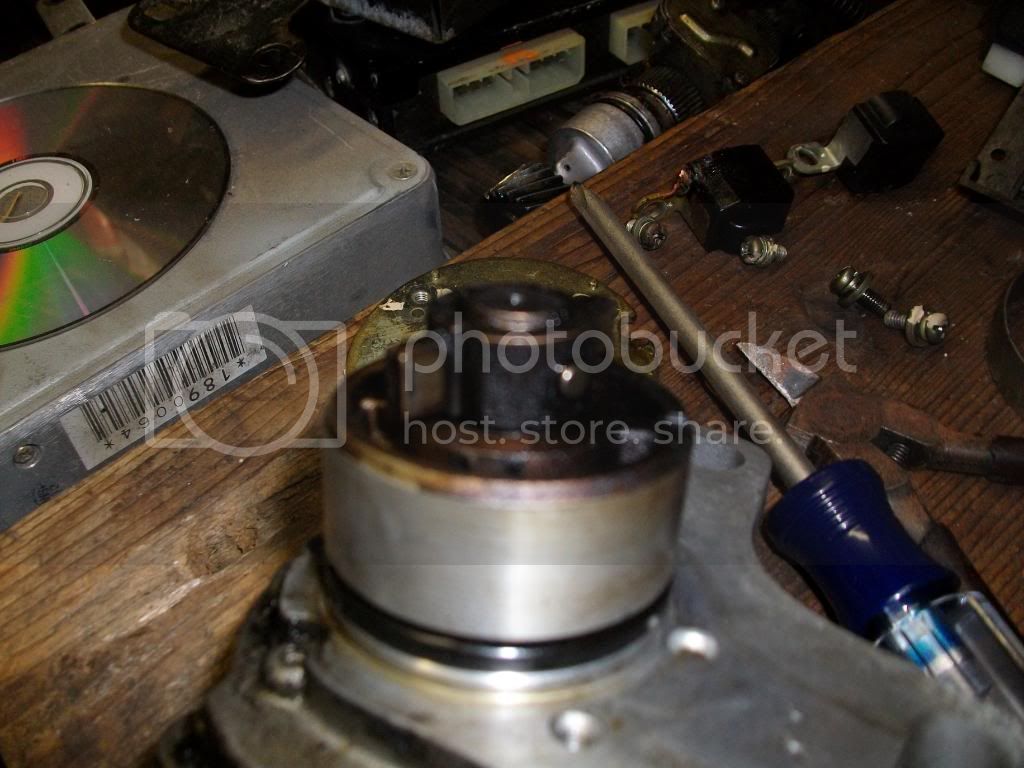

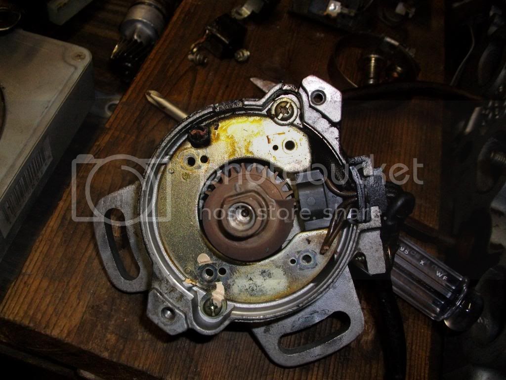

Next, remove the “spacer plate” retaining screws. Lift out the plate and discard.
Next, remove pin from drive “gear” on the cam side of the distributor. You can use a hammer and punch. Using a sharpie or equivalent, make a spot on the “gear” and the shaft, this way you can re0assemble them back together correctly.
Inside the distributor, remove the two phillips screws at the bottom. This holds in the center shaft. Once removed, you should be able to easily remove the distributor shaft.

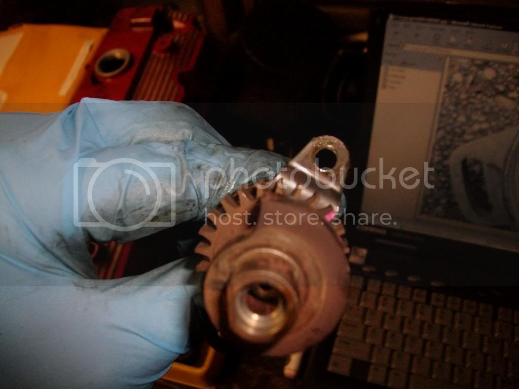

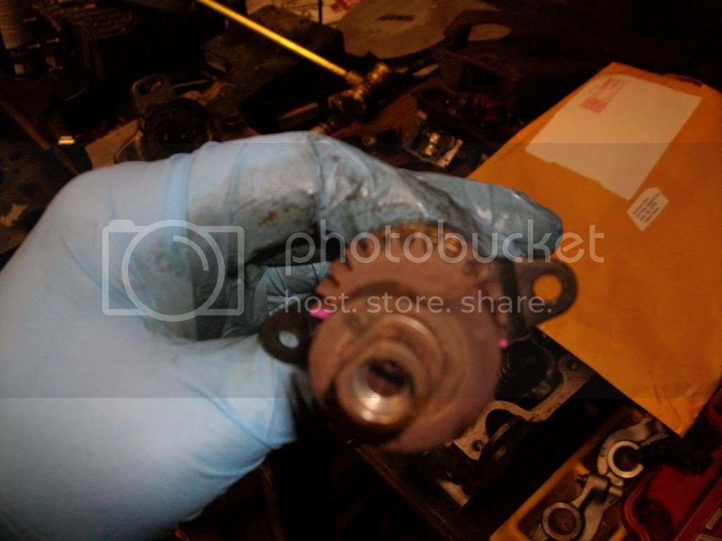

We can now modify the distributor to work with megasquirt. We want to modify the bottom wheel, not the top. You want to grind down two of the “teeth”. Looking at the top wheel, at the point, count back four teeth. We want to remove the forth tooth. Mark this tooth.
We also want to remove the tooth directly opposite of this one. Count 12 teeth (in either direction). Make the 12th tooth. Make this tooth, as we want to remove this one as well. You should have 11 teeth between the two marked teeth on both directions.

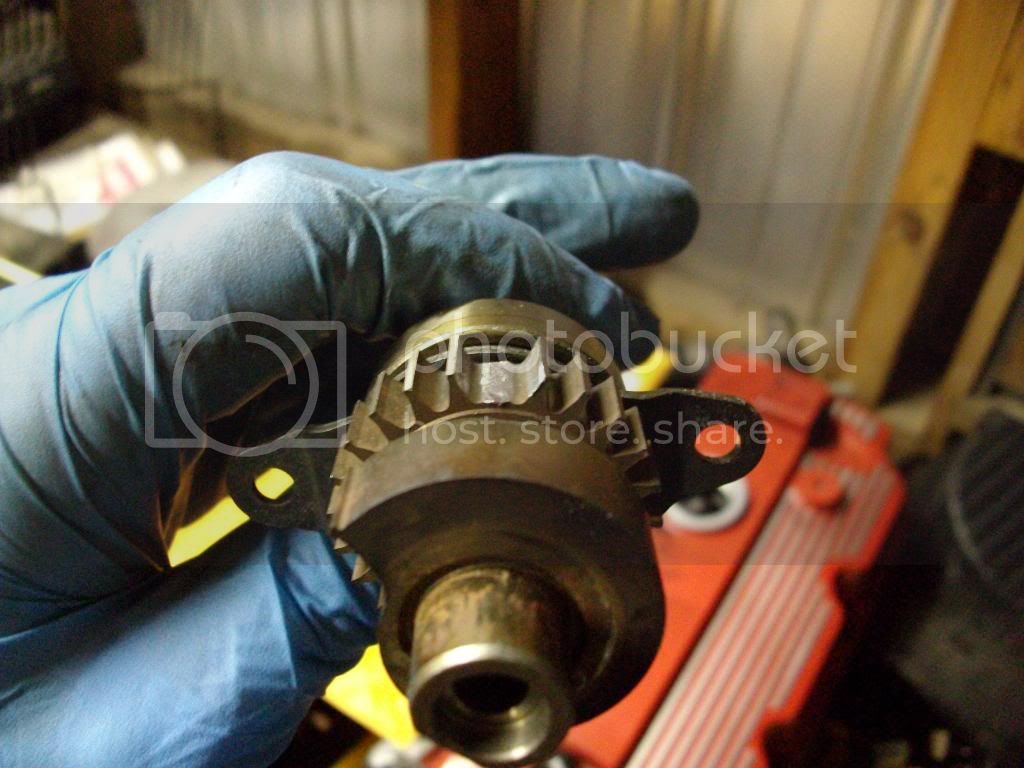

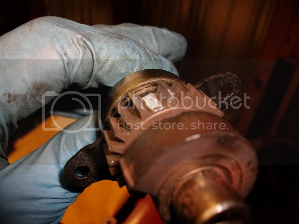

Now, grind down the two teeth. You can use a Dremal tool, a drill with a grinding/cutting bit, air tool, etc. TAKE YOUR TIME! Go slow and take off a little at a time. We are working in a small space with very little material, and you DO NOT want to damage the surrounding teeth. If you happen to “nudge” one, its no big deal, just try to avoid them as much as possible.
This is what you want:

"So once you remove the other sensors by cutting them out, you can then use an ohmmeter to locate the pins to the single sensor left.)
