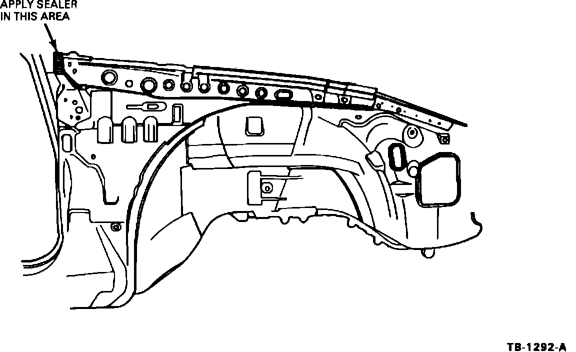

Figure 1:
Figure 2:
Figure 3:
Figure 4:
11. Seal seams as required with Ford Clear Silicone Sealer (D6AZ-19562-AA). See Figures 1 through 4 for proper sealer location.
