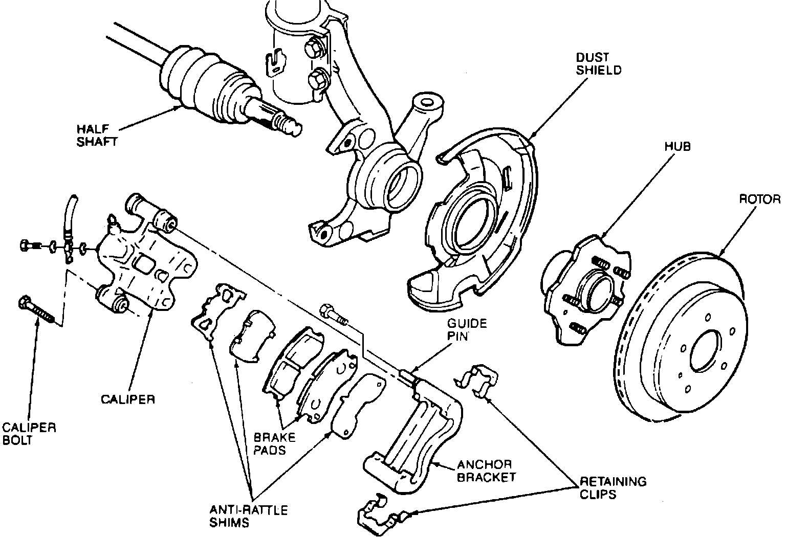

Fig. 8 Exploded View Of Front Disc Brake Assembly:

4. Using a screwdriver, pry caliper outboard.
5. Remove caliper mounting bolt, Fig. 8, then slide caliper upward.
6. Slide caliper off guide pin, then tag anti-rattle shims so shims can be reinstalled in their original position.
7. Remove brake pads from caliper anchor.
8. Remove retaining clips from brake pads.

3. Install caliper onto guide pin and pivot caliper down over brake pads.
4. Install caliper mounting bolt and torque to specification, Fig. 8.
