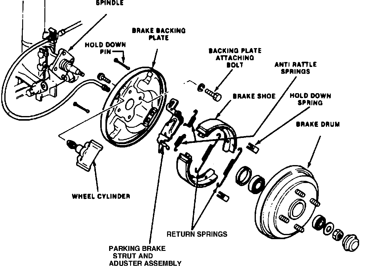

Fig. 1 Exploded View Of Rear Drum Brake:

6. Remove brake shoe hold-down springs, then pull front shoe away from backing plate, disconnect return springs and remove front shoe, Fig. 1.
7. Remove return springs from rear shoe, then disconnect anti-rattle spring attaching rear shoe to parking brake strut and remove rear shoe.
