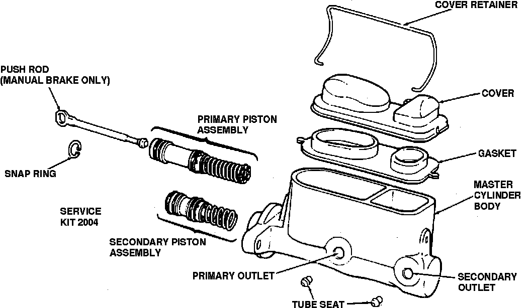

Disassembly and Assembly
Fig. 21 Exploded View Of Bendix Dual Master Cylinder Used w/Disc Brakes:

Disassemble
1. Remove cover and diaphragm then drain brake fluid from master cylinder, Fig. 21.
2. On front wheel drive models, using a screwdriver, pry up on reservoir and remove primary port from master cylinder, Fig. 22.
3. Rotate reservoir out of way and remove sealing grommet from master cylinder casting.
4. Using a socket, remove fluid control valve.
5. On all models, depress primary piston and remove snap ring from retaining groove at open end of bore.
6. Remove primary and secondary piston assemblies from master cylinder. If secondary piston does not readily come out, apply air pressure to secondary outlet port to remove.

Assembly
1. Install secondary piston assembly into bore, spring end first.
2. Install primary piston assembly, spring end first.
3. Depress primary piston and install snap ring.
4. On front wheel drive models, install fluid control valve and torque to 97-115 inch lbs.
5. Lubricate new grommet with brake fluid and install in primary port.
6. Install reservoir in new grommet.
7. On all models, fill and bench bleed master cylinder. Refer to Brake Bleeding.
8. Install cap and diaphragm on master cylinder reservoir.
