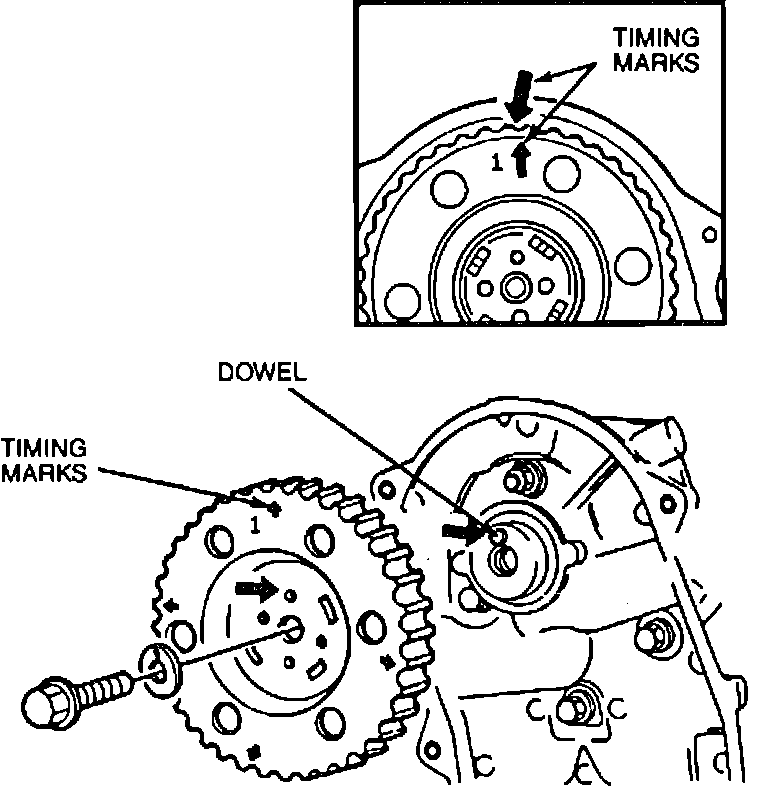

Fig. 9 Installing Camshaft Sprocket:

9. Install camshaft sprocket, aligning No. 1 mark on sprocket with dowel on camshaft, Fig. 9.
10. Install sprocket retaining bolt, prevent sprocket from rotating, then tighten retaining bolt to specifications.
