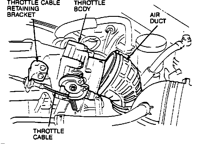

3. Remove the accelerator cables from the throttle body.
4. Remove the air duct from the throttle body.

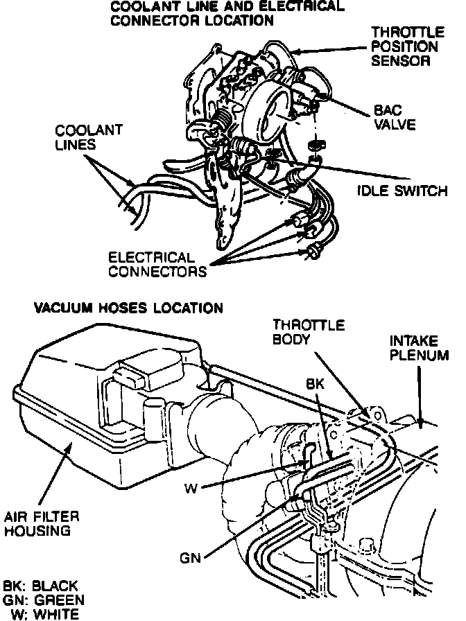

Throttle Body:
5. Mark all vacuum and coolant hoses for ease of reassembly and remove the hoses from the throttle body and engine block.
6. Disconnect the Throttle Position Sensor connector, Idle Switch connector, and the Bypass Air Control Valve connector.

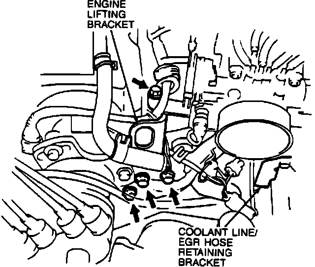

Engine Lifting Bracket:
7. Remove the engine lifting bracket mounting bolt from the throttle body.
8. Remove the coolant line/EGR hose retaining bracket from the throttle body.
Throttle Cable Retaining Brackets:
9. Remove the throttle cable retaining brackets from the intake plenum.

11. Remove the PCV hose from the intake plenum.
12. Remove the retaining nut and bolts from the vacuum line assembly bracket at the rear of the intake plenum.
13. Mark all vacuum lines for ease of reassembly and remove the lines from the intake plenum.

3. Install all vacuum lines to the intake manifold at their correct location as noted during removal.

8. Install the engine lifting bracket mounting bolt and coolant line/EGR hose retaining bracket to the throttle body.
9. Install all vacuum and coolant hoses to the throttle body at their correct location as noted during removal.
10. Connect the Throttle Position Sensor connector, idle switch connector, and bypass air control valve connector.
