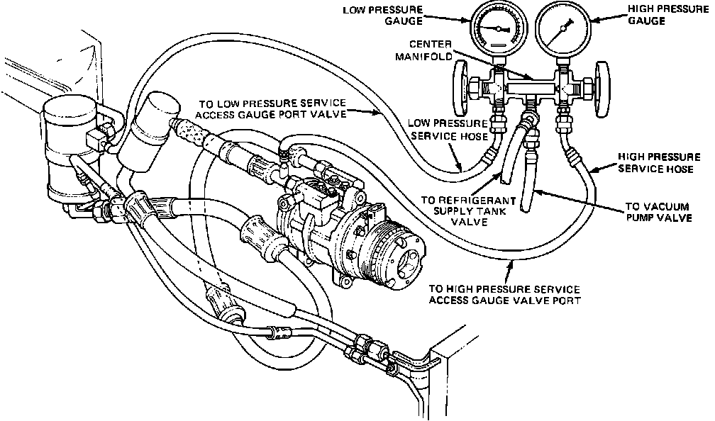

Fig. 8 Refrigerant system service connections. Fixed orifice systems:
Charging From Small Containers
When charging from small cans, do not open manifold gauge set high pressure (discharge) gauge valve, as this can cause the containers to explode.
1. Connect a suitable refrigerant dispensing valve and valve retainer such as Motorcraft tool YT-280 or equivalent to the refrigerant can.
2. Connect manifold gauge set to system. Fig. 8. Connect hose normally connected to R-12 tank to special valve on small can adapter. Make sure valve is closed (full clockwise position).
3. When can is connected, charge system according to procedure under ``Charging from Drum.'' When can is empty, close valve and remove can. Connect new can open valve and continue charging until correct weight of refrigerant has entered system. Note capacity of refrigerant cans. When specifications require the use of a portion of a can, weigh it to ensure proper amount of refrigerant is installed.
