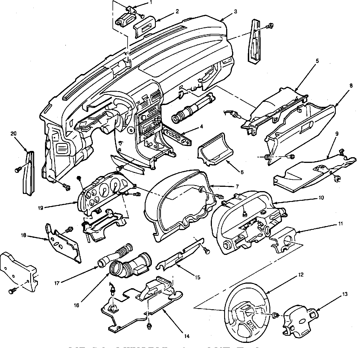

Fig. 57 Exploded View Of I/P. Probe:
Refer to Fig. 57, when performing this procedure.
2. Remove steering wheel insert, then remove steering wheel attaching nut.
3. Mark steering wheel and steering column shaft for assembly reference and remove wheel with steering wheel puller tool No. T67L-3600-A or equivalent.
4. Remove two screws securing column cover, then remove cover.
Fig. 9 Instrument Cluster Module Attaching Screw Location:
Fig. 59 Removing Hinge Screws From Cluster. Probe:
5. Remove nine attaching screws from the cluster module, Fig. 58.
6. Carefully pull cluster module outward to gain access to the electrical connectors.
7. Disconnect seven electrical connectors and remove ignition illumination bulb.
8. Remove cluster module, then loosen two cover hinge screws, Fig. 59.
9. Remove six screws from the instrument cluster cover, then remove the cover.
10. Remove lower cluster cover panel, then the four attaching screws from the cluster.
11. Disconnect electrical connectors from the back of the cluster, and remove cluster.
