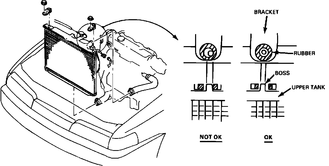

4. Make sure the radiator is centered in the radiator upper brackets without friction so that the radiator can move freely as an effective dynamic damper. If not, adjust the radiator or brackets as follows:
Figure 1:
a. Adjust the position of the upper brackets so that radiator boss is centered, Figure 1.
b. Adjust the position of the radiator upper hose so that the radiator is not pushed or pulled out of position.
