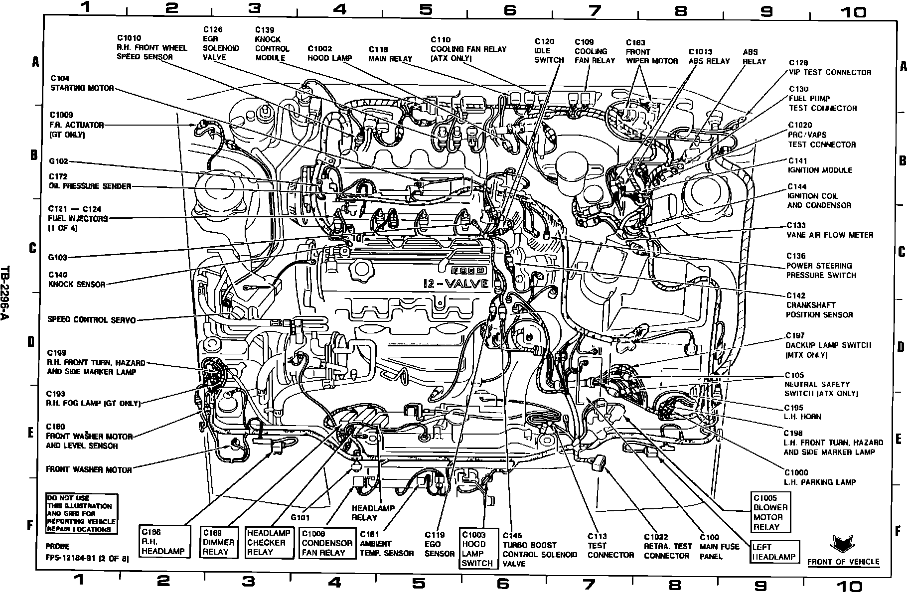

Figure 1:
The wiring connectors join the body and engine wiring looms. A diagram of the connectors and the circuits routed through them is shown on pages 151-1, 2, 3 and 4 of the 1991 Probe EVTM or Figure 1.

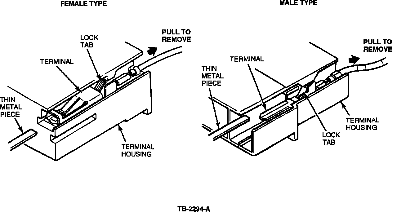

Figure 2:
1. Inspect the wiring and connector for corrosion damage. Repair the wiring as needed.
a. Use a small brush and/or compressed air to clean and remove corrosion or water from the connector.
b. If required, use an electric contact cleaner. Refer to the 1991 Probe Shop Manual, Page 18-00-3, for connector and wire/terminal removal procedure, Figure 2.
