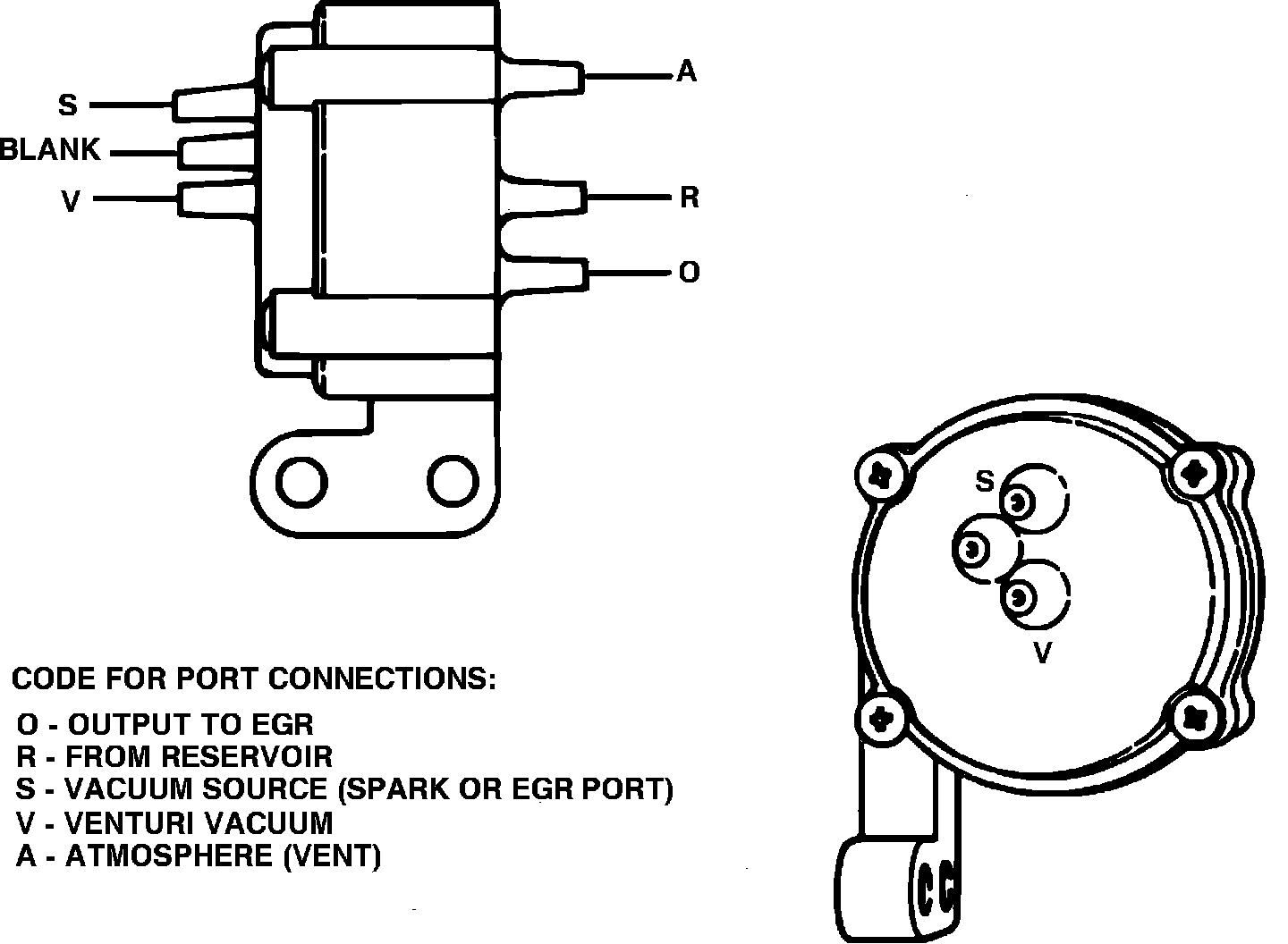

Fig. 40 Venturi vacuum amplifier:
A Venturi Vacuum Amplifier, Fig. 40, uses a weak venturi-vacuum signal to produce a strong intake manifold vacuum to operate the EGR valve, thereby achieving an accurate, repeatable and almost exact proportion between venturi airflow and EGR flow. This assists in controlling oxides of nitrogen with minimal sacrifice in driveability.

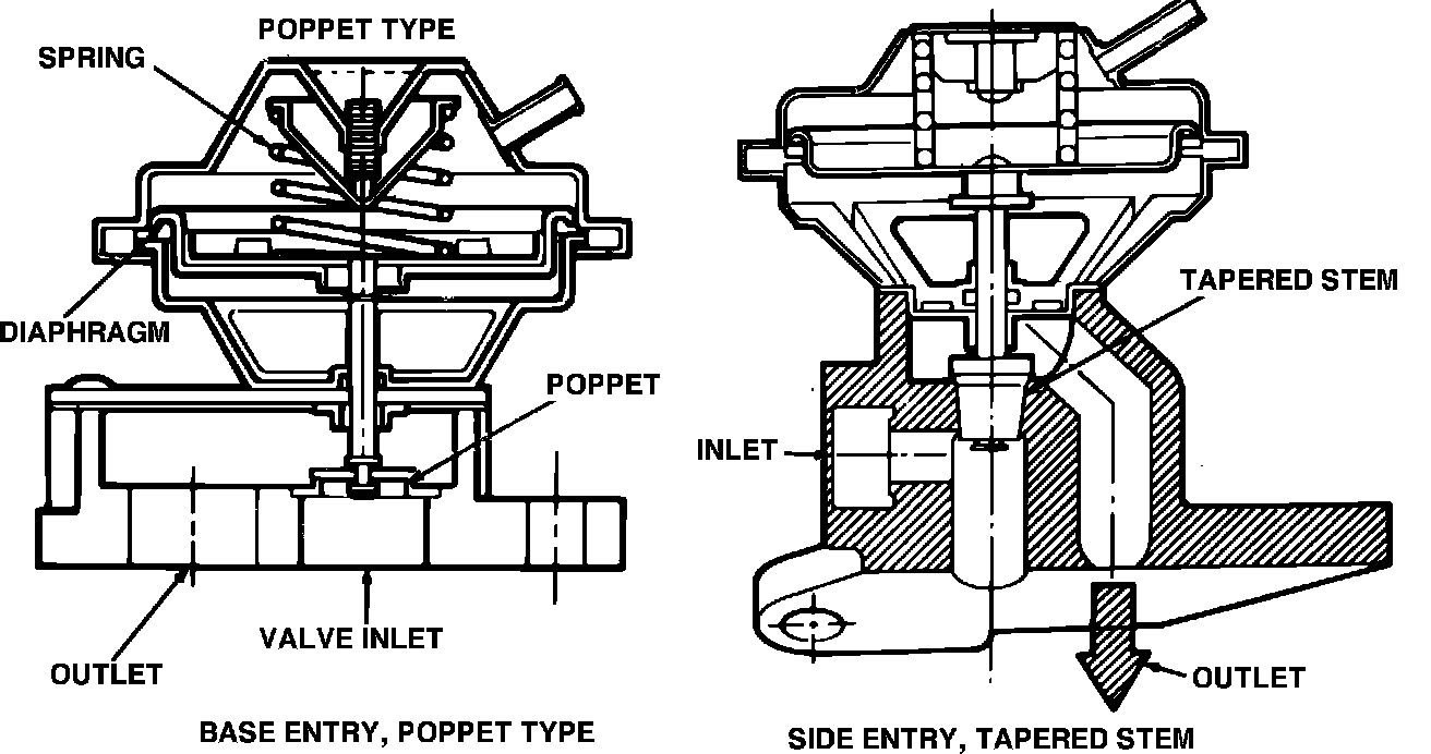

Fig. 41 Ported type EGR valves:
Ported type valves, Fig. 41, may be of the poppet or tapered stem design and can have base or side entry. The two passages connecting the exhaust system to intake manifold are blocked by a valve which is opened by vacuum and closed by spring pressure.

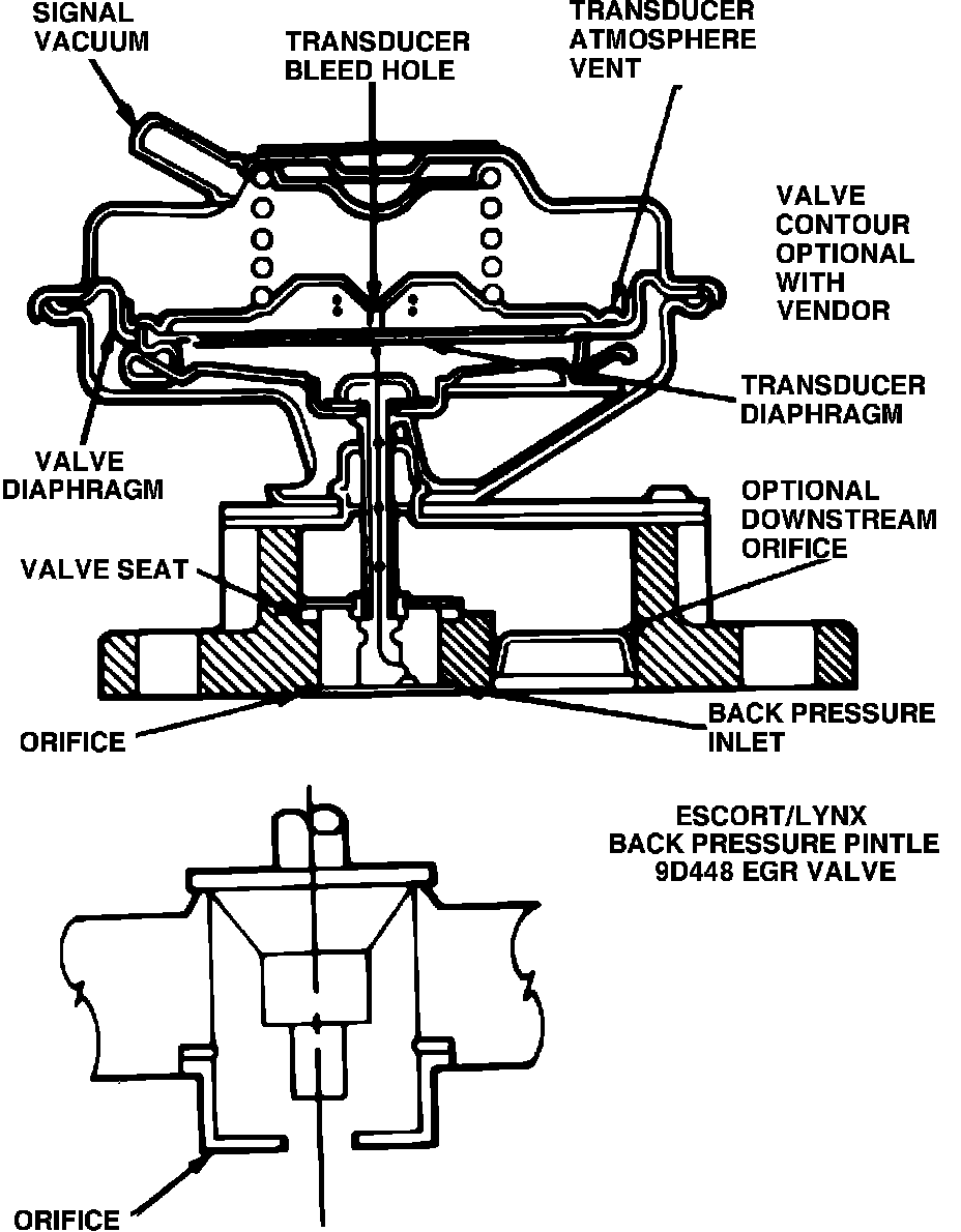

Fig. 42 EGR valve with integral back pressure transducer:
Two types of back pressure valves are used. The integral back pressure transducer valve, Fig. 42, cannot be opened by vacuum until the bleed hole is closed by exhaust back pressure. When open, the valve oscillates at a level dependent on the exhaust back pressure flowing through the orifice. Valve opening increases as signal vacuum and exhaust back pressure increases.
Fig. 43 EGR valve with remote back pressure transducer:
Some vehicles use an EGR valve with a remote back pressure transducer, Fig. 43. This assembly operates the same as the EGR valve with integral back pressure transducer valve and is serviced only as an assembly.
