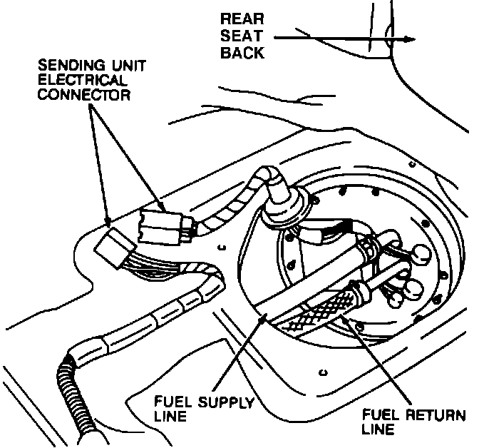

Fuel Sending Unit Connectors:

4. Disconnect the sending unit electrical connector.
5. Remove the attaching screws from the sending unit access cover and remove the cover.
6. Remove clamps securing the fuel supply and return line hoses and remove the hoses from the sending unit.
Fuel Pump And Sending Unit Assembly:
7. Remove all mounting screws from the sending unit and remove the unit from the vehicle.
