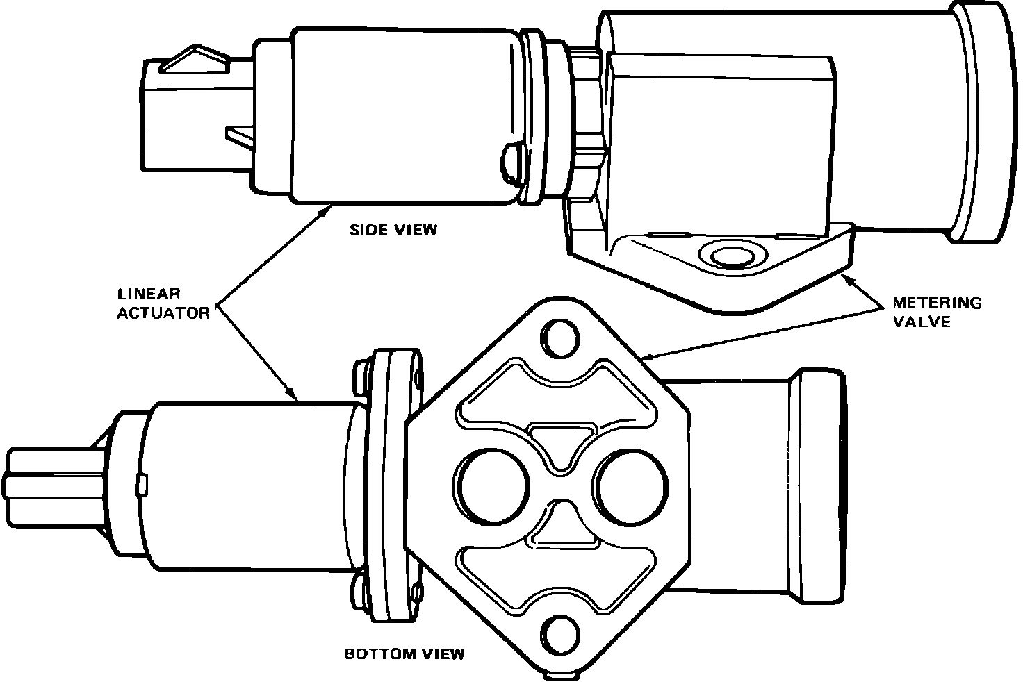

Fig. 1 Air bypass valve solenoid:

1. Remove the Idle Speed Control By-Pass Air ISC-BPA valve from the throttle body.
2. Remove the electrical solenoid assembly from the mechanical portion of the ISC-BPA valve by removing the two screws, then sliding the mechanical portion away from the solenoid.
