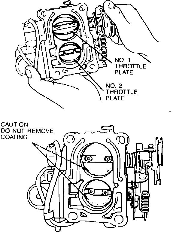

NOTE: The No. 2 throttle plate is preset at the factory to begin opening after the NO. 1 throttle plate opens approximately 25 degrees (MTX) or 10 degrees (ATX).
^ Check that the No. 1 and No. 2 throttle plates move smoothly when the throttle lever is moved from fully closed to fully open.
^ Replace is necessary.
CAUTION: Do not remove the thin sealing coating form the throttle plates or bore.
Throttle Plate:
