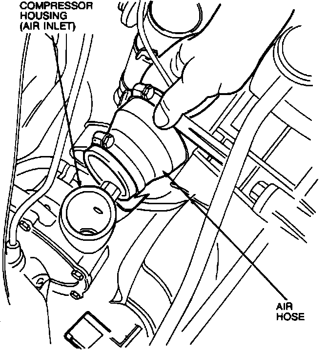

Compressor Housing Air Outlet Hose:
3. Remove the air hose from the compressor housing (outlet) of the turbocharger.
Compressor Housing Air Inlet Hose:
4. Remove the air hose from the air inlet side of the turbocharger assembly.

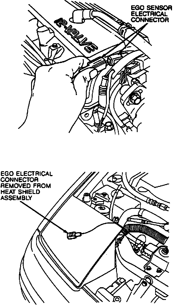

EGO Sensor Electrical Connector:
NOTE: It may be necessary to disconnect the EGO sensor electrical connector and move the wiring assembly away from the heat shield assembly.

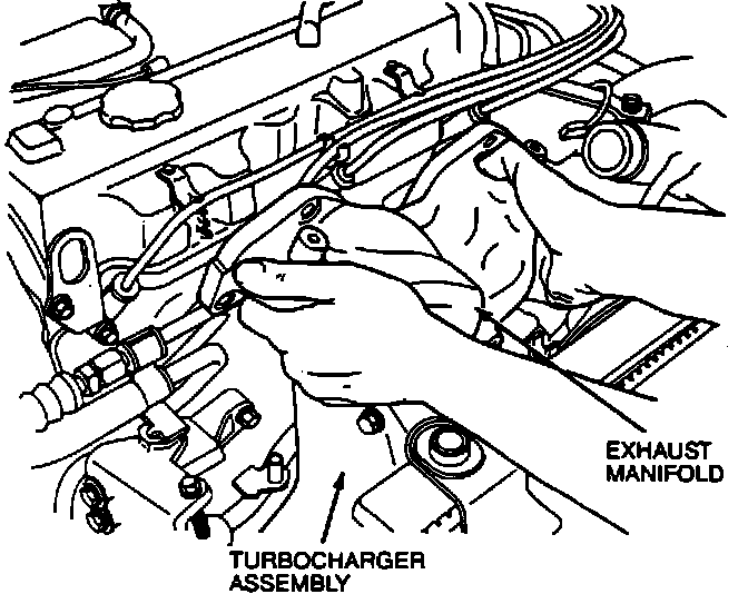

Turbocharger Assembly And Exhaust Manifold:
18. Remove the exhaust manifold and the turbocharger as an assembly.
Turbocharger Assembly:
19. Remove the exhaust manifold, the turbocharger to converter inlet pipe joint pipe and heat shield assembly from the turbocharger.
