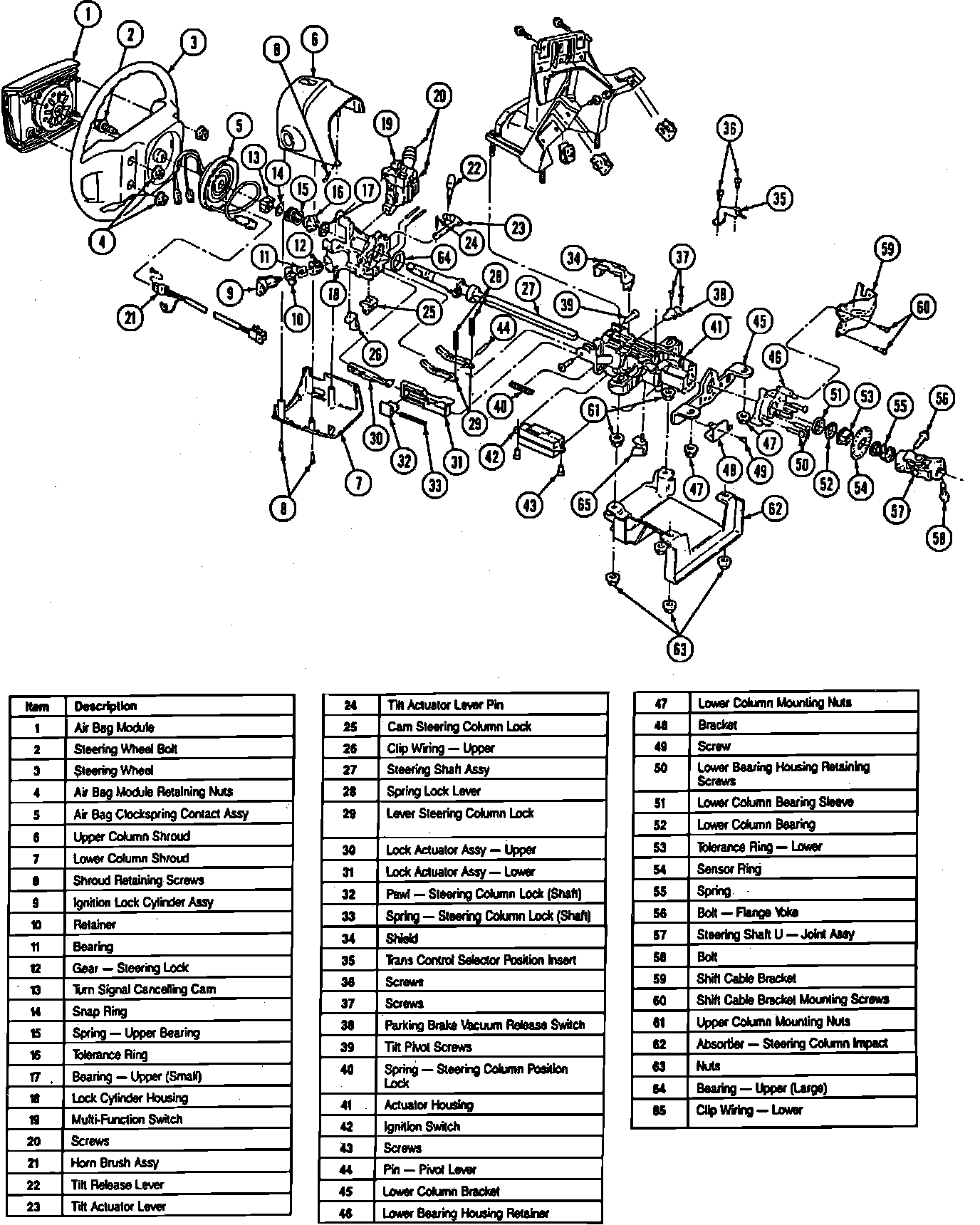

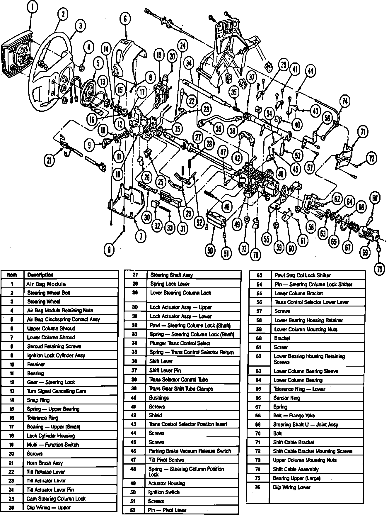

Fig. 4 Exploded View Of Steering Column W/Column Shift:
Fig. 5 Exploded View Of Steering Column W/Console Shift:
Fig. 6 Exploded View Of Steering Column:
Fig. 7 Exploded View Of Steering Column:
Removal
Refer to Figs. 4 through 7, for component identification.
