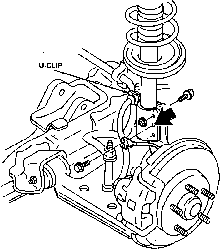

Fig. 9 Disconnecting Brake Line From Strut:

6. On all models, remove brake caliper, the U-clip from brake line hose, then slide from strut bracket, Fig. 9.
7. Remove steering knuckle to strut attaching bolts.
