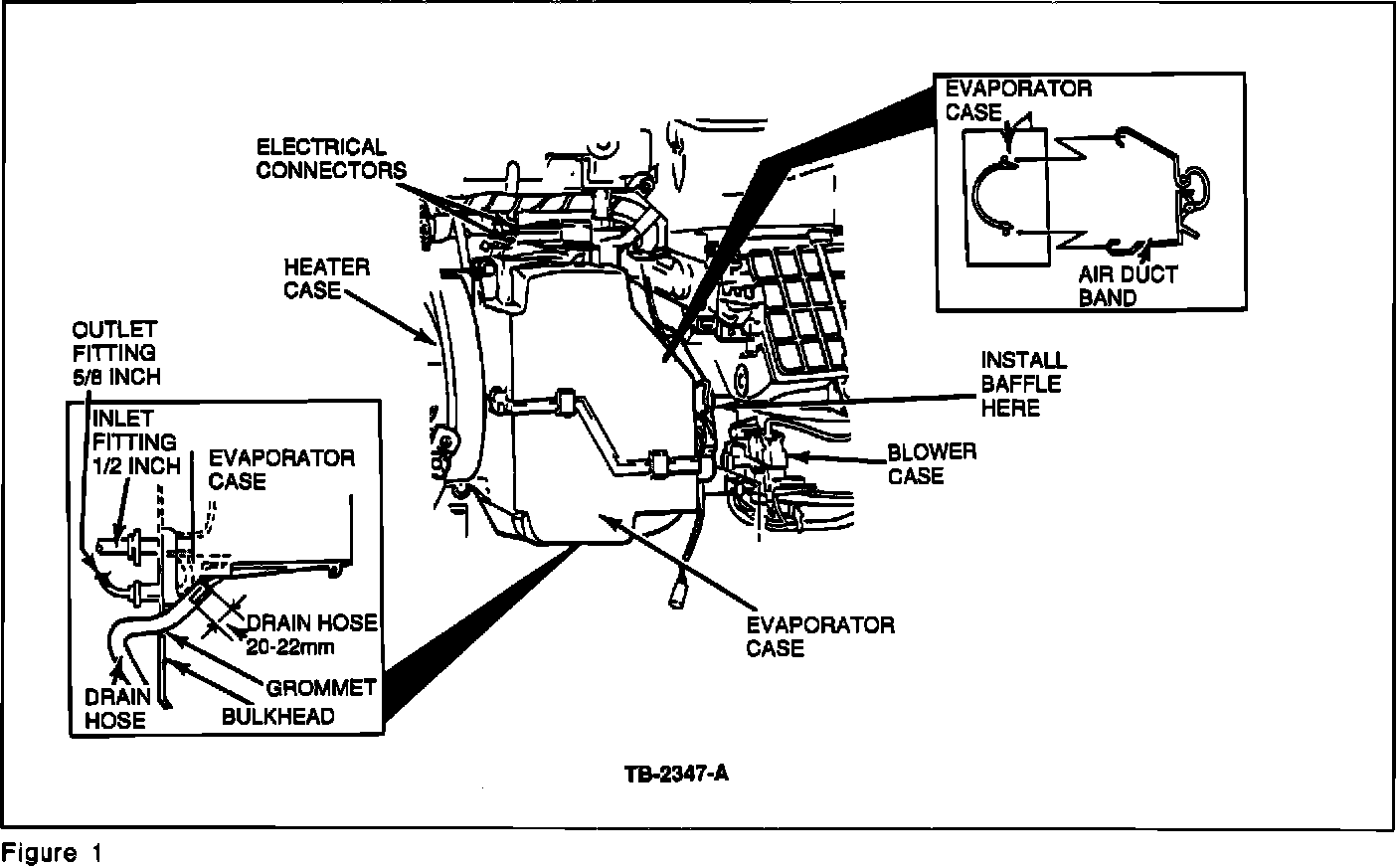

3. Inspect for the correct position of the A/C drain tube grommet through the cowl. This can be seen from inside the vehicle, Figure 1. If the grommet is missing, damaged or mispositioned, refer to the parts block of this article for the replacement part number.
4. Inspect the A/C evaporator core tube seal, Figure 2.
a. Perform the inspection from the engine compartment by looking between the charcoal canister and the cowl.
b. Use a light to observe the seal at the inlet/outlet tubes of the evaporator core.
c. If it is missing, refer to the parts block of this TSB article. Replace it if damaged or reposition as needed.
5. Refer to Figure 3 for the installation location of the special air baffle (F12Z-18A384-A).

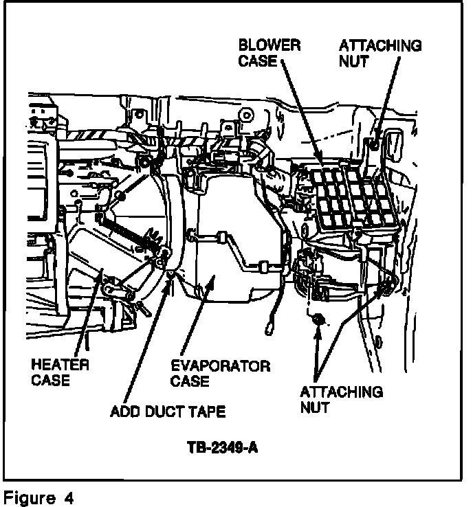

11. If moisture leakage was observed when the blower was turned to the highest position, proceed as follows:
a. Remove the air duct band.
b. Add a piece of duct tape, 6-7, (152-178 mm) long to the lower joint(s) that were leaking, Figure 4.
c. Reinstall the air duct band.
