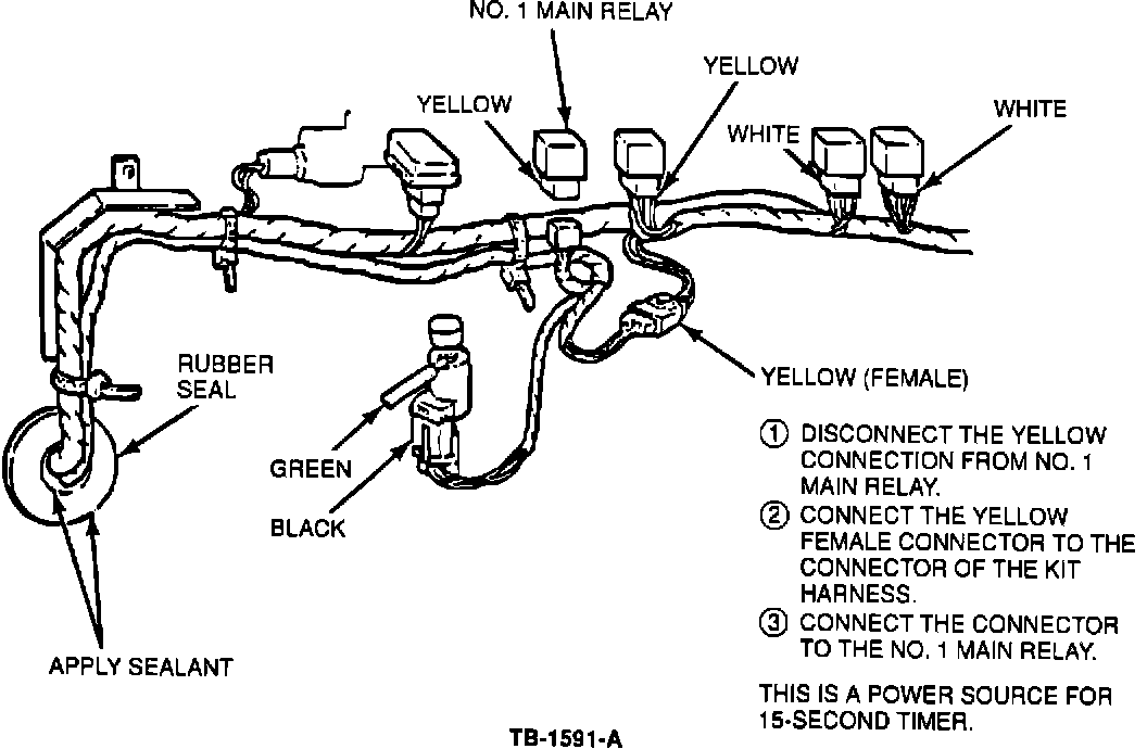

Engine Compartment Modifications
Figure 8:
Figure 9:
1. Connect the black connector to the new solenoid valve.
2. Disconnect the yellow wire harness from the No. 1 main relay. Install the yellow connector into the kit harness connector, Figure 8.
3. Connect the remaining harness connector to the No. 1 relay, Figure 9.
4. Secure the wire harnesses with plastic tie straps.
5. Use silicone sealer around the rubber grommet and new wire harness to prevent water entry.
6. Check for vacuum.
a. Attach a vacuum gauge to the fuel pressure regulator valve assembly.
b. Start the engine.
