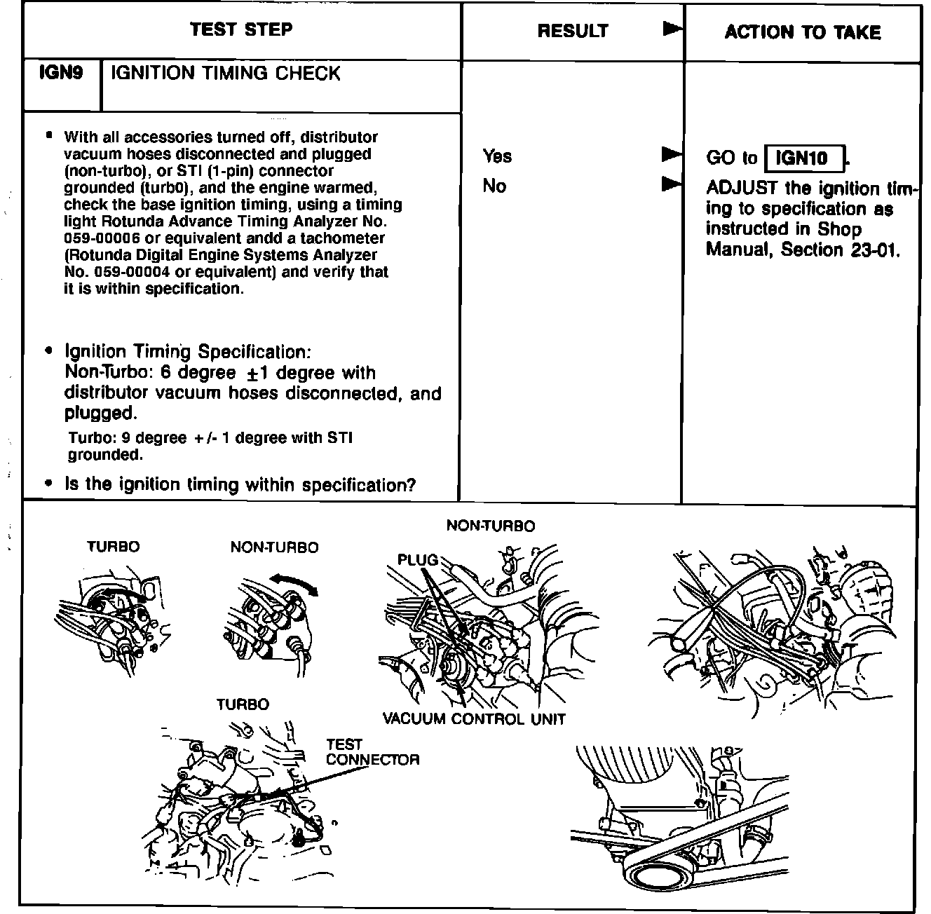

SHOP MANUAL - 1989 - SECTION 23-01 - IGNITION SYSTEM - DIAGNOSIS AND TESTING PROCEDURE - TEST STEP IGN9 REVISED
Article No. 89-12A-20
FORD: 1989 PROBE
ISSUE: Test Step IGN9 in the Diagnosis and Testing procedure of the Ignition System on page 23-01-11 of the 1989 Probe Shop Manual has been revised.
ACTION: Refer to the page following this TSB article for the revised procedure and illustration in Test Step IGN9. This information should be inserted in your 1989 Probe Shop Manual, page 23-01-11.
OASIS CODES: 680000
