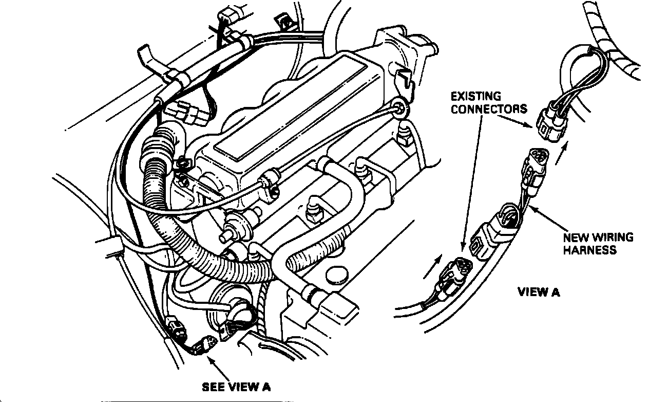

FIGURE 1:
1. Fasten the new wire harness and resistor assembly to the pressure regulator control solenoid bracket, Figure 1.
2. Disconnect the EGR valve position sensor wire harness connector (connector C140).
3. Connect one end of the new service wire harness, (E92Z-12A690-A) to the EGR valve position sensor. Connect the other end of the new service wire harness to the C140 connector.
4. Secure the new service wire harness to the existing wire harness in the area with three (3) tie-straps.
