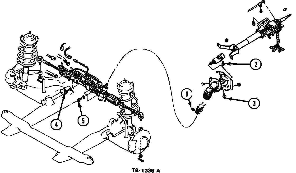

4. Unequal steering assistance in either direction can be caused by:
^ Binding in the steering column.
^ Improper alignment of the steering gear.
Figure 1:
To correct a binding condition, proceed as follows:
a. Loosen the intermediate shaft bolts, Figure 1 - Items 1, 2 & 3.
b. Release the tilt lock on the steering column. Move the steering column all the way up and then move it all the way down.
c. Lock the tilt steering column in the full up position. Tighten the bolts in sequence 1, 2 then 3 to 20 lb.ft. (27 N-m).
Road test the vehicle. If the condition is not corrected, align the steering gear as follows:
d. Loosen bolts 3, 4 and 5, Figure 1.
e. Start the engine, move the steering wheel 180~ in both directions 3 to 4 times.
f. Center the steering wheel. Tighten bolt # 3 to 20 lb.ft. (27 N-m). Then, tighten bolts # 4 & # 5 to 27-40 lb.ft. (37-54 N-m).
Road test the vehicle. If the binding or unequal effort is still experienced, inspect all front suspension components for damage and correct positioning.
The cause could also be internal binding of the steering gear. Refer to the 1989 Probe Shop Manual, Section 13-46 for service details.
