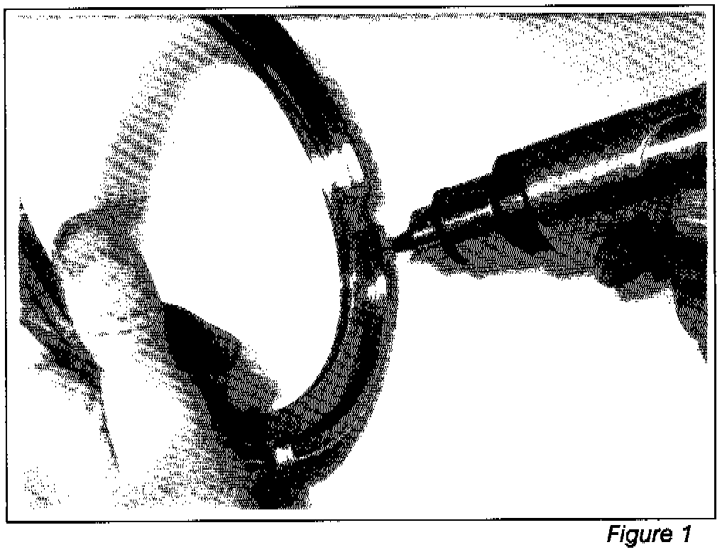

2. Drill a .030 hole in the reverse piston. (Figure 1) This is just like the T-35 that would cross leak in the valve body and drag the reverse band. The .030 hole creates an exhaust so the clutch won't come on while driving forward.

^ Drill a .030 hole in the reverse piston.
