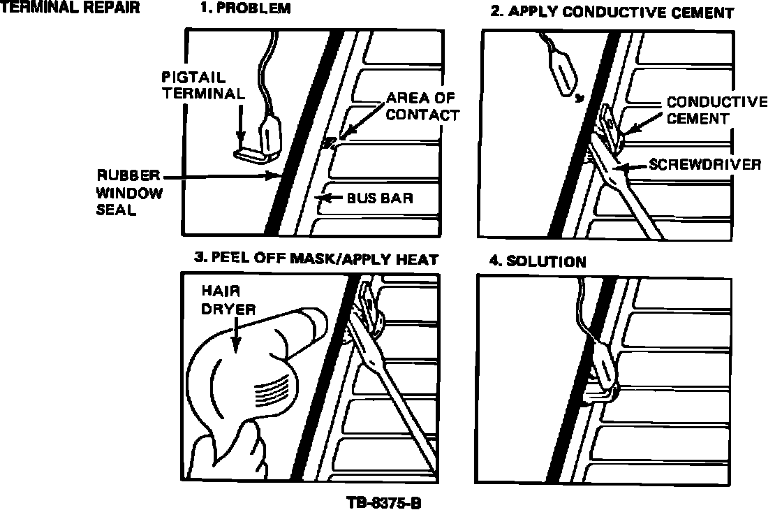

ISSUE: An inoperative electric rear window defroster (heated backlites) may be caused by bond separation of the pigtail terminal to bus bar or broken grid lines.
Figure 1:
Figure 2:
ACTION: Use a rear window defroster service kit to repair pigtail connections, Figure 1 and grid line breaks, Figure 2.
