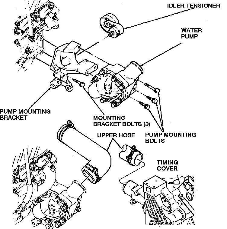

Fig. 14 Water Pump Removal:
1. Raise and support vehicle.
2. Drain cooling system, then remove water pump belt.
3. Remove upper hose and heater hose from pump, Fig. 14.
4. Remove lower radiator hose from water pump steel tube.
5. Remove steel tube brace bolt from mounting bracket.
6. Remove water pump attaching bolts, then the pump.
7. Reverse procedure to install.
