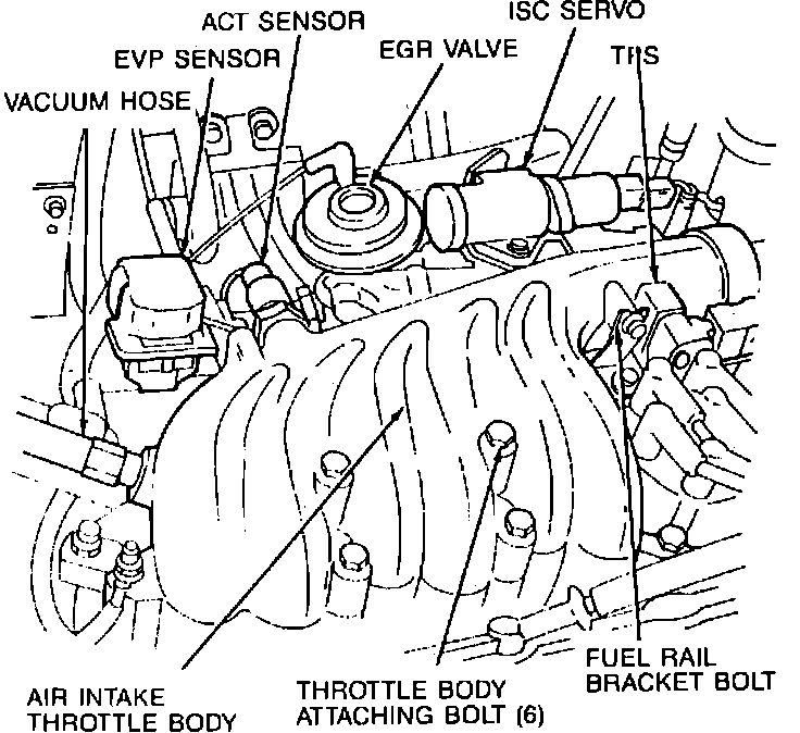

Fig. 6 Rocker Arm Cover Removal:
RIGHT SIDE
2. Disconnect air cleaner tube from throttle body, then remove plastic shield from throttle body.
3. Disconnect EGR supply tube, if equipped and all vacuum hoses from air intake throttle body.
4. Disconnect ACT sensor, Fig. 6.
5. Disconnect ISC servo.
6. Disconnect TPS, then remove EVP sensor (if equipped).
7. On models with manual transaxle, disconnect throttle cable.
8. On models with automatic transaxle, disconnect throttle valve control cable.
9. On all models, remove fuel rail bracket bolt from throttle body.
10. Remove air intake attaching bolts, then lift off throttle body.
11. Disconnect spark plug wires, then position injector harness aside.
12. Remove rocker arm cover attaching bolts, then the cover.
13. Reverse procedure to install, noting the following:
a. Lightly oil bolt and stud threads prior to installation.
b. Apply bead of Silicone Sealer or equivalent at cylinder head intake manifold rail step.
c. Tighten rocker arm cover bolt to specifications.
d. Torque EGR supply tube 37 ft. lbs.
