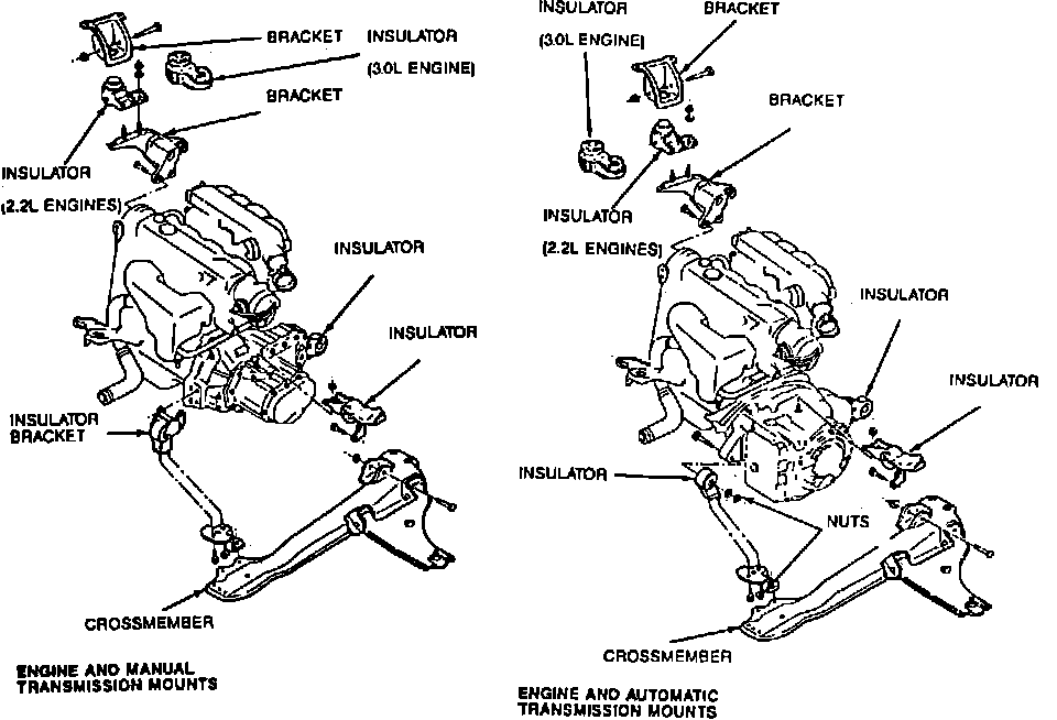

Fig. 1 Engine Mounts:
32. Disconnect lower rear transmission mount.

34. Disconnect lower front engine mount and righthand upper engine mount at timing cover.
35. Disconnect lefthand upper engine mount at transaxle case.
