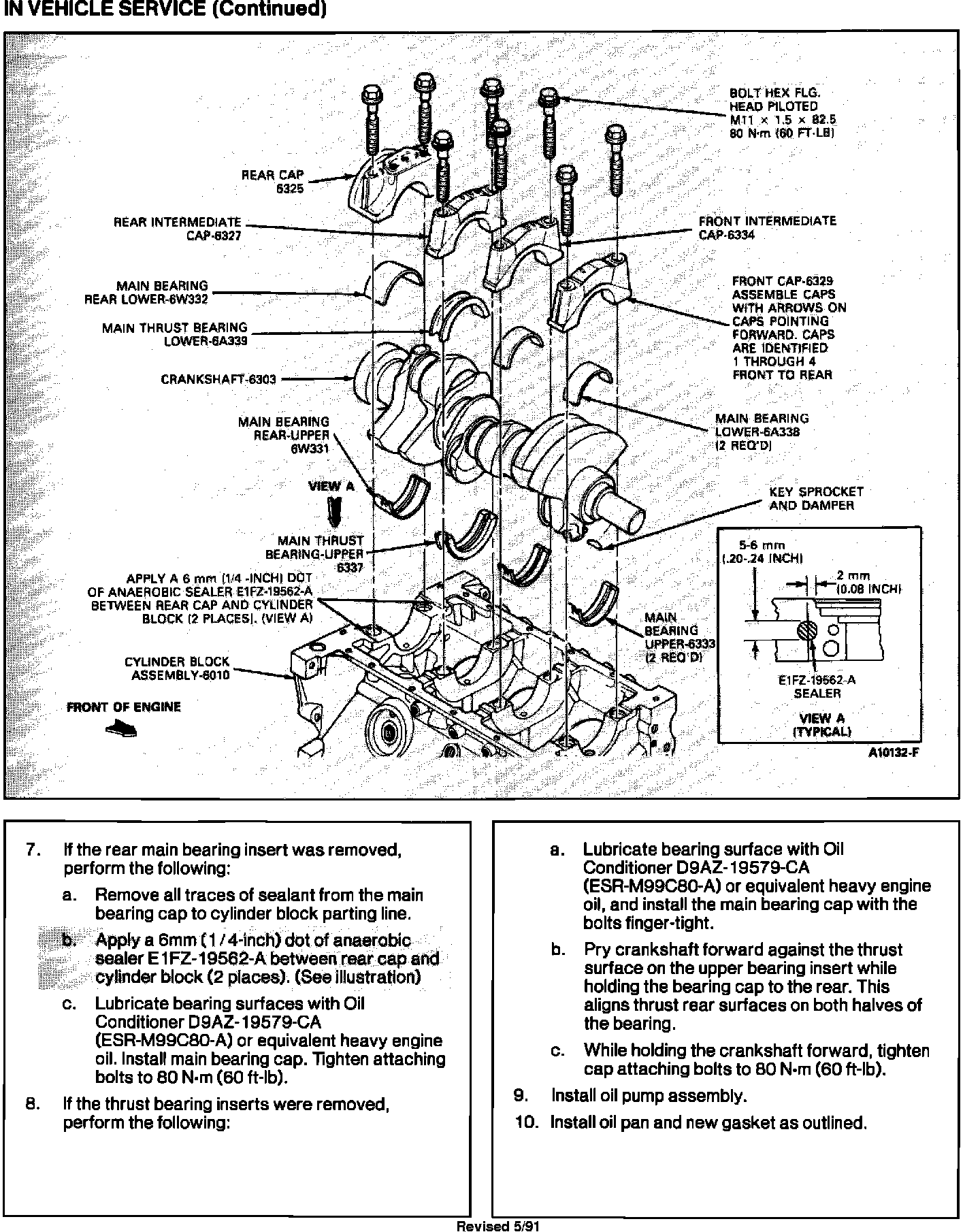

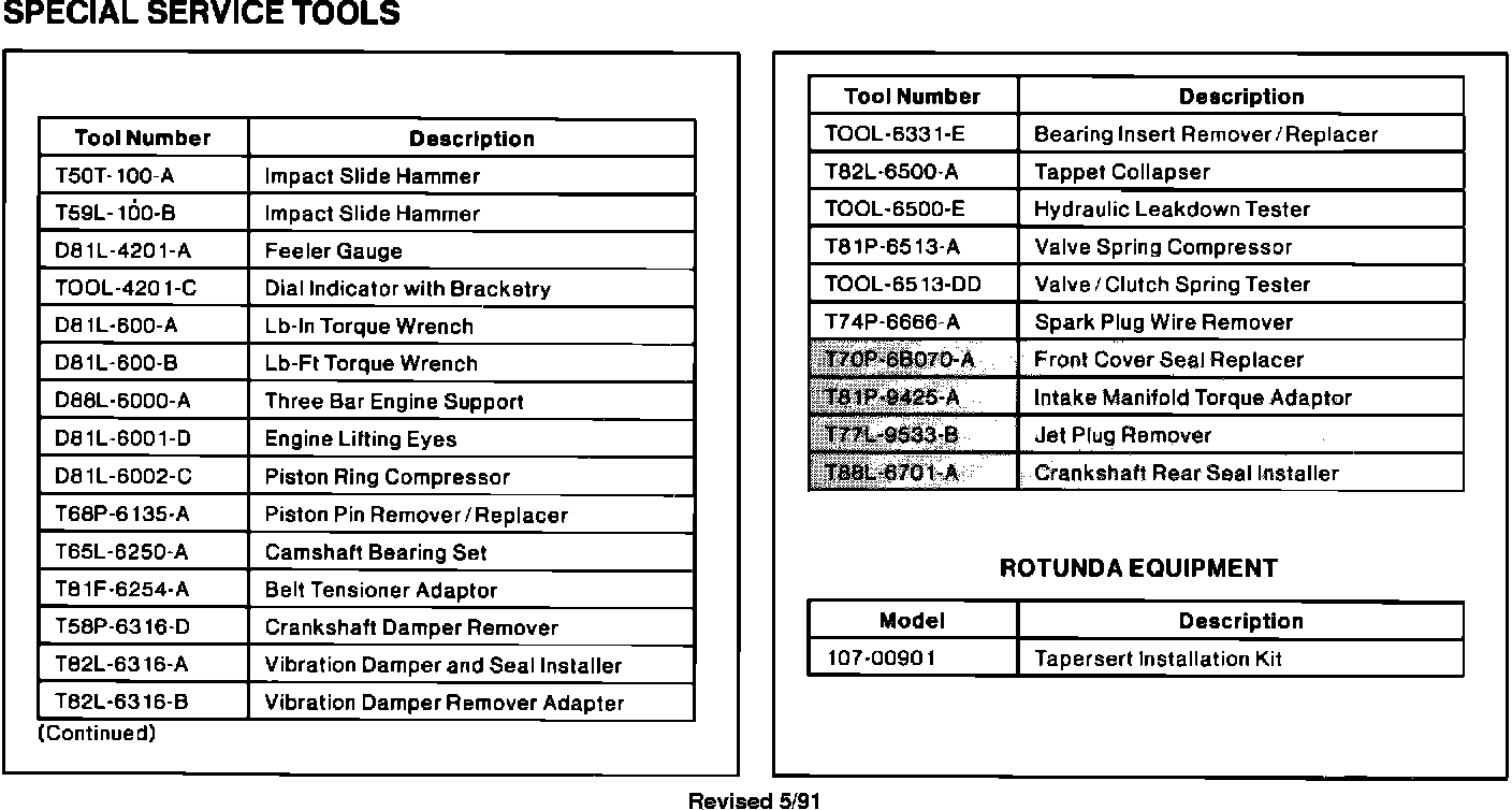

Specifications for the identification and usage of Anaerobic Sealing Compound and Crankshaft Rear Seal Installation Tool have been revised. The following Shop Manuals are affected:
^ 1986 through 1991 Taurus/Sable
^ 1990 and 1991 Probe
^ 1987 and 1988 Aerostar
^ 1989 and 1990 Aerostar/Ranger/Bronco II
^ 1991 Aerostar/Explorer/Ranger
ACTION:
Refer to the pages in this TSB article for the revised information.
NOTE:
THE PAGES IN THIS TSB ARTICLE ARE FROM 1991 SHOP MANUALS; HOWEVER, THE REVISED INFORMATION APPLIES TO ALL SHOP MANUALS LISTED ABOVE.

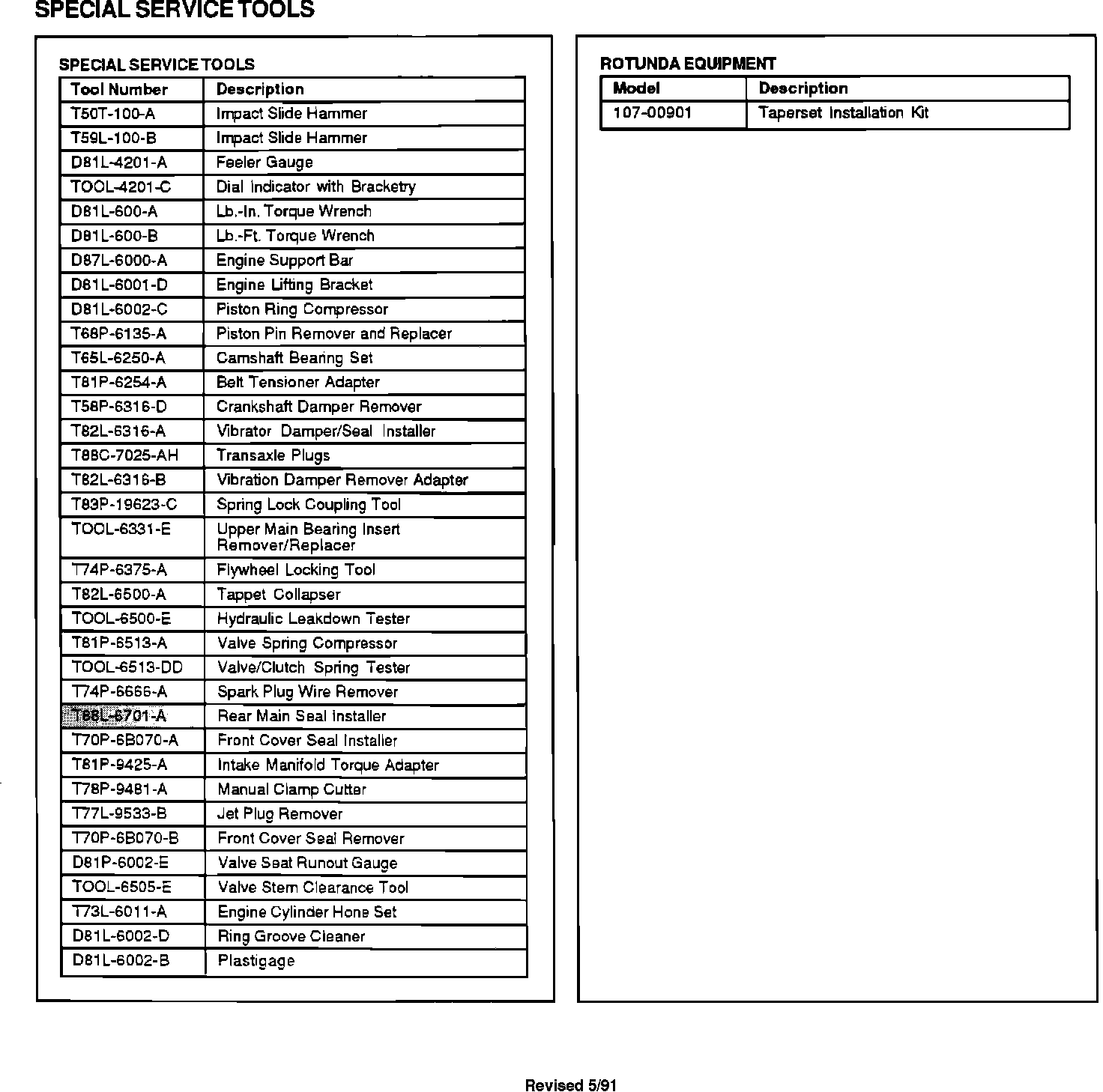

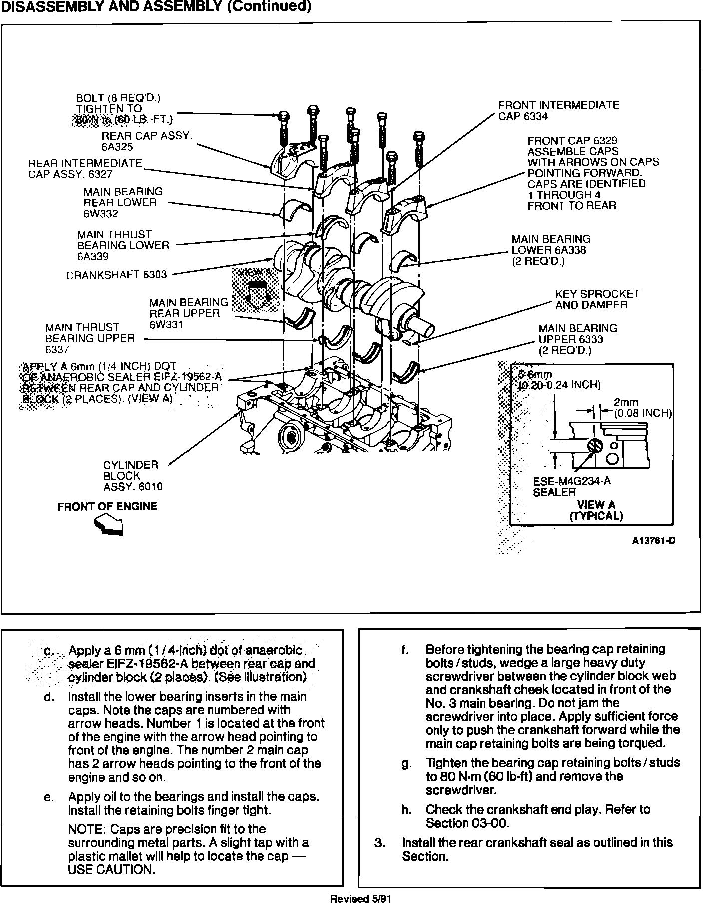

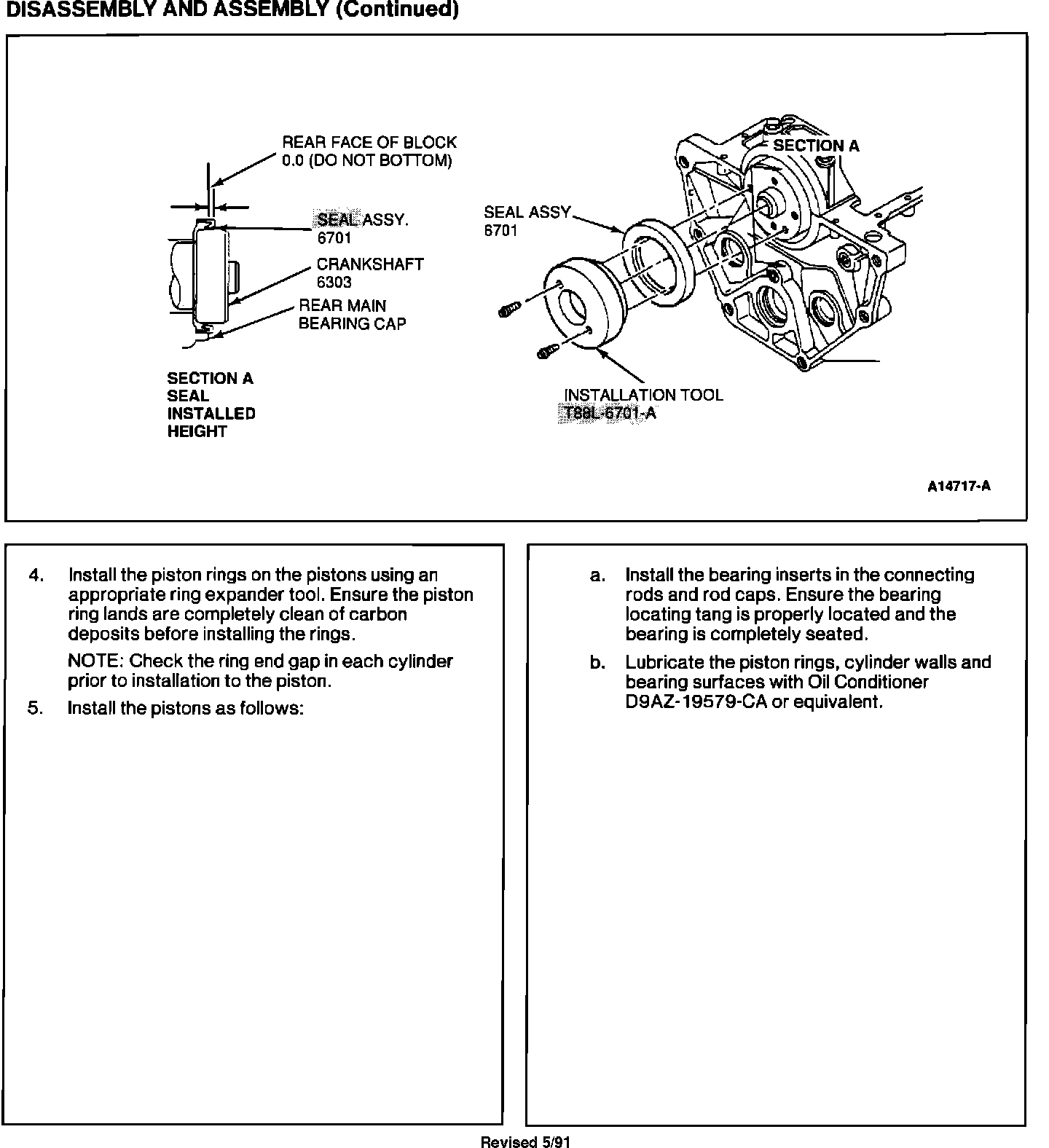

Taurus/Sable 3.0L rear main seal, rear cap covers and cylinder block

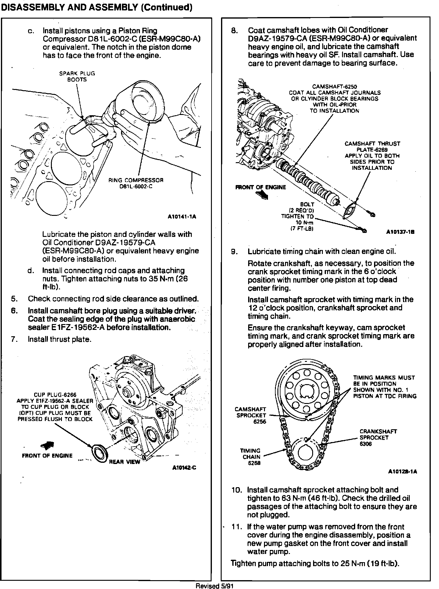

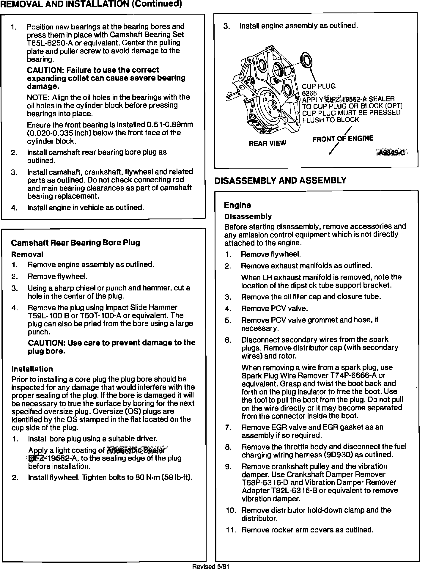

Taurus/Sable camshaft bore plug & special service tools
Probe 3.0L rear cap and cylinder block

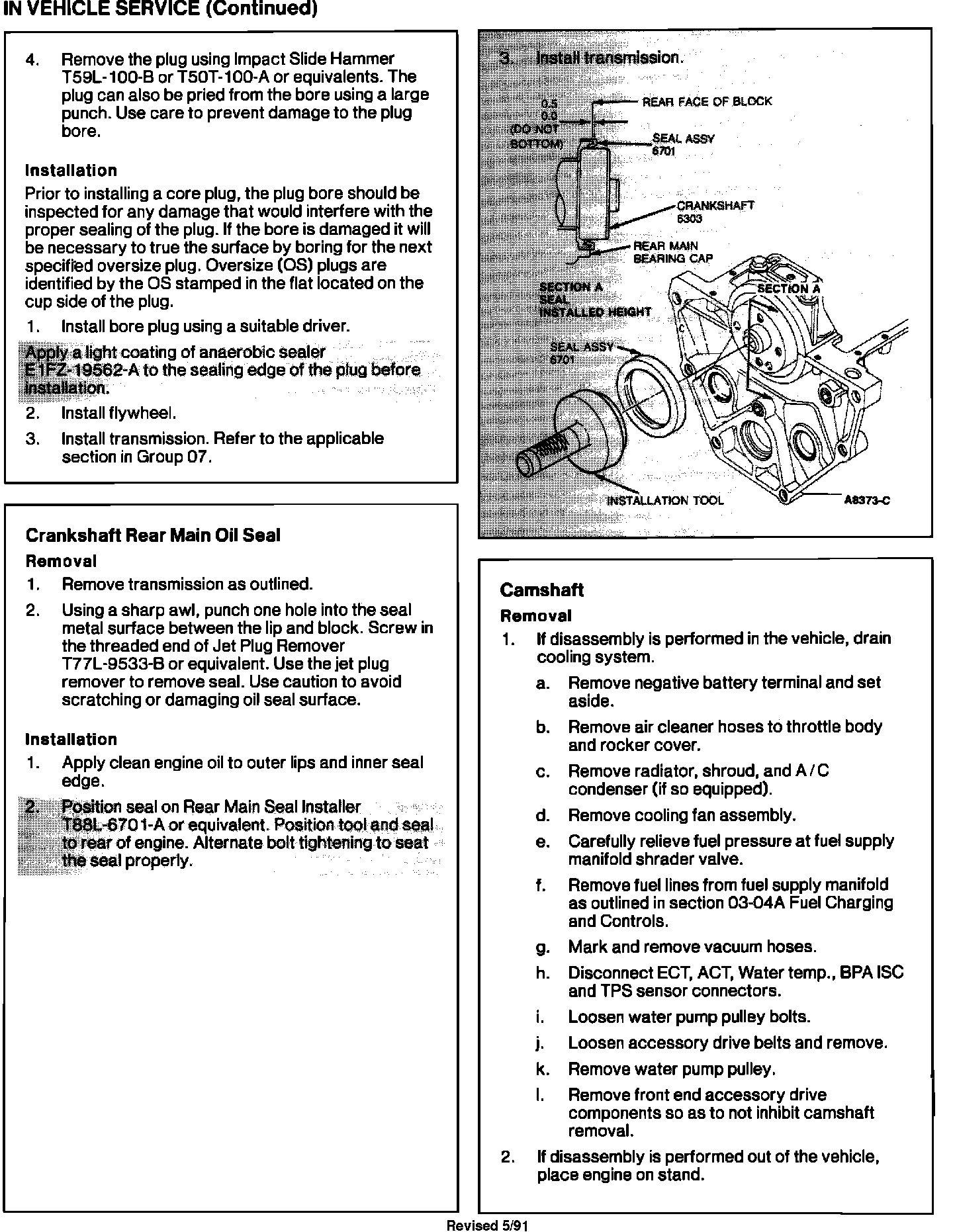

Probe 3.0L rear seal and bore plug
Special tools
Aerostar/Ranger 3.0L rear cap and cylinder block, crankshaft repair main oil seal
Aerostar/Ranger 3.0L main crank seal
Aerostar/Ranger 3.0L cap plug
