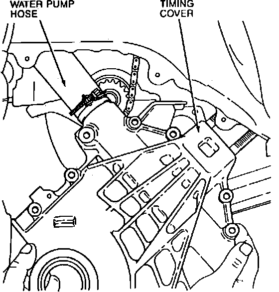

Fig. 7 Timing Cover Removal:

7. Pull timing cover over end of crankshaft, then lower it through engine compartment. Timing cover may be removed with water pump upper hose attached, Fig. 7.
