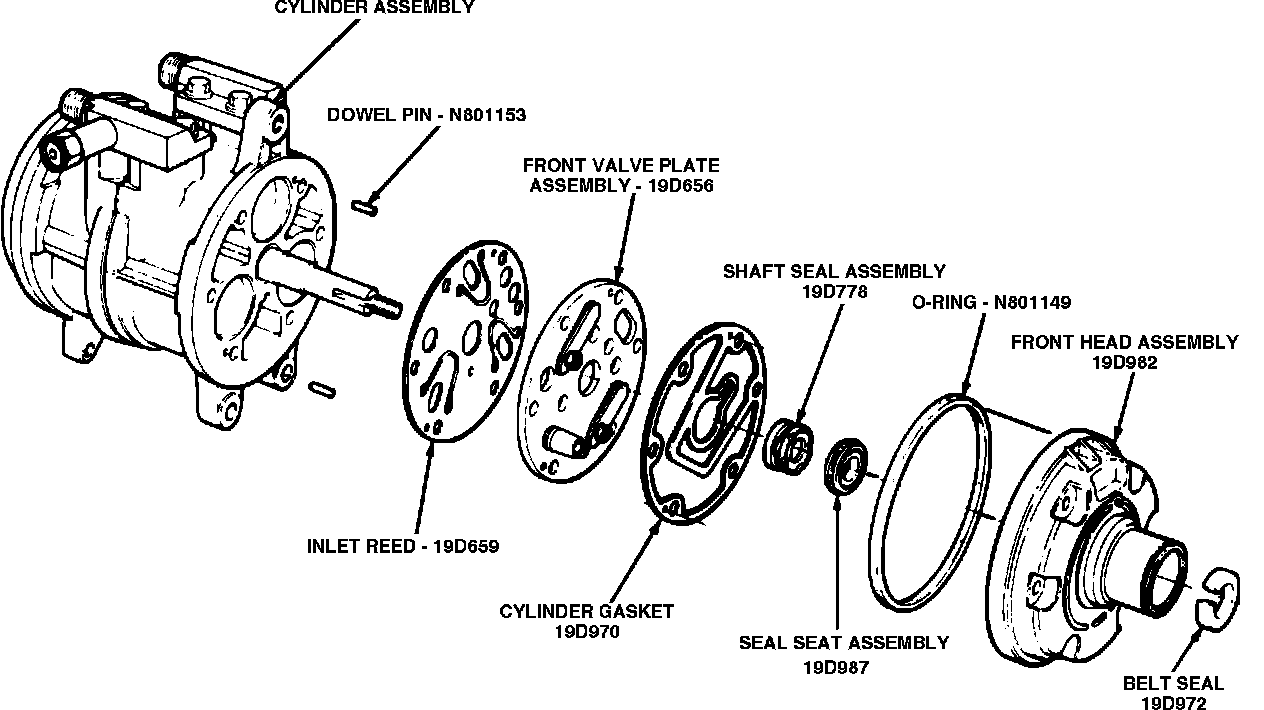

Fig. 12 Disassembled view of valve plate & front head:
5. Assemble a new cylinder gasket to head side of valve plate assembly, Fig. 12.

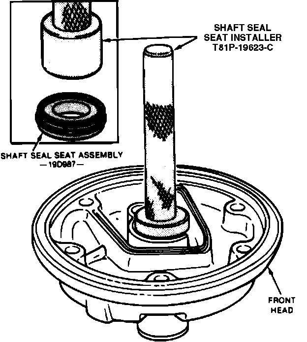

Fig. 13 Shaft seal seat assembly installation:
6. Lubricate shaft seal with clean refrigerant oil and install seat in front head with groove on seat sealing surface up, using tool T81P-19623-C or equivalent, Fig. 13.
7. Lubricate shaft seat with clean refrigerant oil and assemble seal to compressor with sealing surface toward end of shaft. Engage internal plate of seal with two flats notched into shaft. Avoid handling carbon sealing surface of seal assembly to prevent damaging surface.
