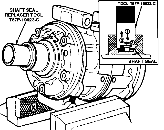

Fig. 18 Compressor shaft seal removal:
8. Remove shaft seal using tool T87P-19623-C or equivalent, Fig. 18.

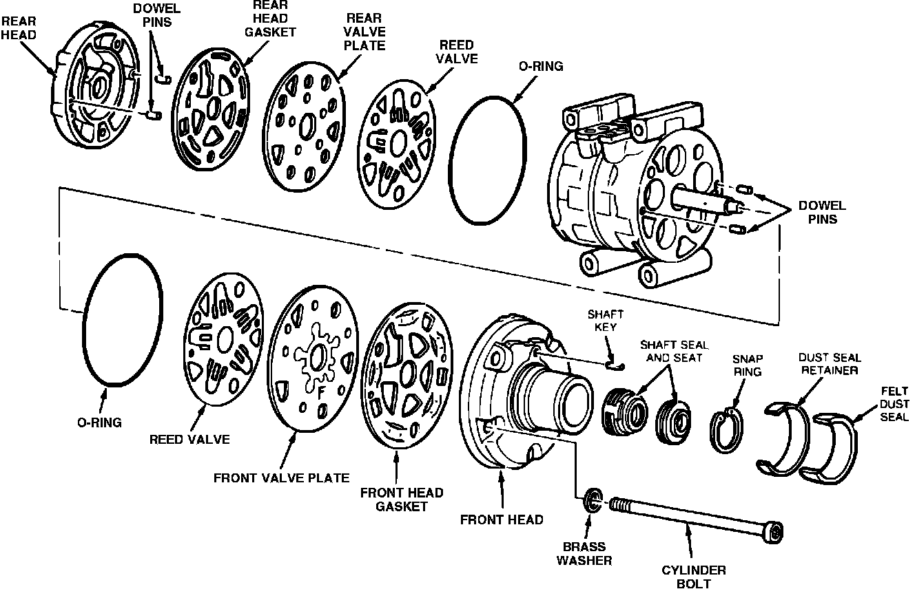

Fig. 19 Disassembled view of compressor.:
10. Remove rear head, head gasket, rear valve plate, reed valve and dowel pins from compressor, Fig. 19.
11. Remove front head, head gasket, front valve plate, reed valve and dowel pins from compressor, Fig. 19.

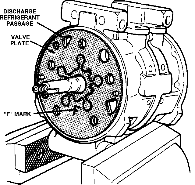

Fig. 20 Compressor front valve plate installation:
5. Lubricate front valve plate (marked with an ``F'') and install on cylinder assembly. The ``F'' mark must be showing when valve plate is installed, Fig. 20.
6. Lubricate rear valve plate (marked with an ``R'') and install on cylinder assembly. The ``R'' must be showing when valve plate is installed.
