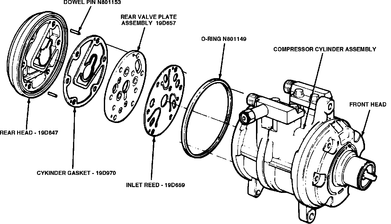

Fig. 15 Disassembled view of valve plate & rear head:
6. Remove dowel pin(s), Fig. 15.
7. Remove inlet reed from rear head and valve plate assembly.
Fig. 10 Valve plate removal:
8. Remove valve plate assembly from rear head with tool T81P-19623-B or equivalent, Fig. 10.
9. Remove cylinder gasket from head.

1. Install dowel pin(s) in rear head.
2. Install cylinder gasket on head over dowel pin(s).
3. Install valve plate assembly on cylinder head over dowel pin(s).
4. Lubricate inlet reed with clean refrigerant oil and install inlet reed on valve plate, Fig. 15.
