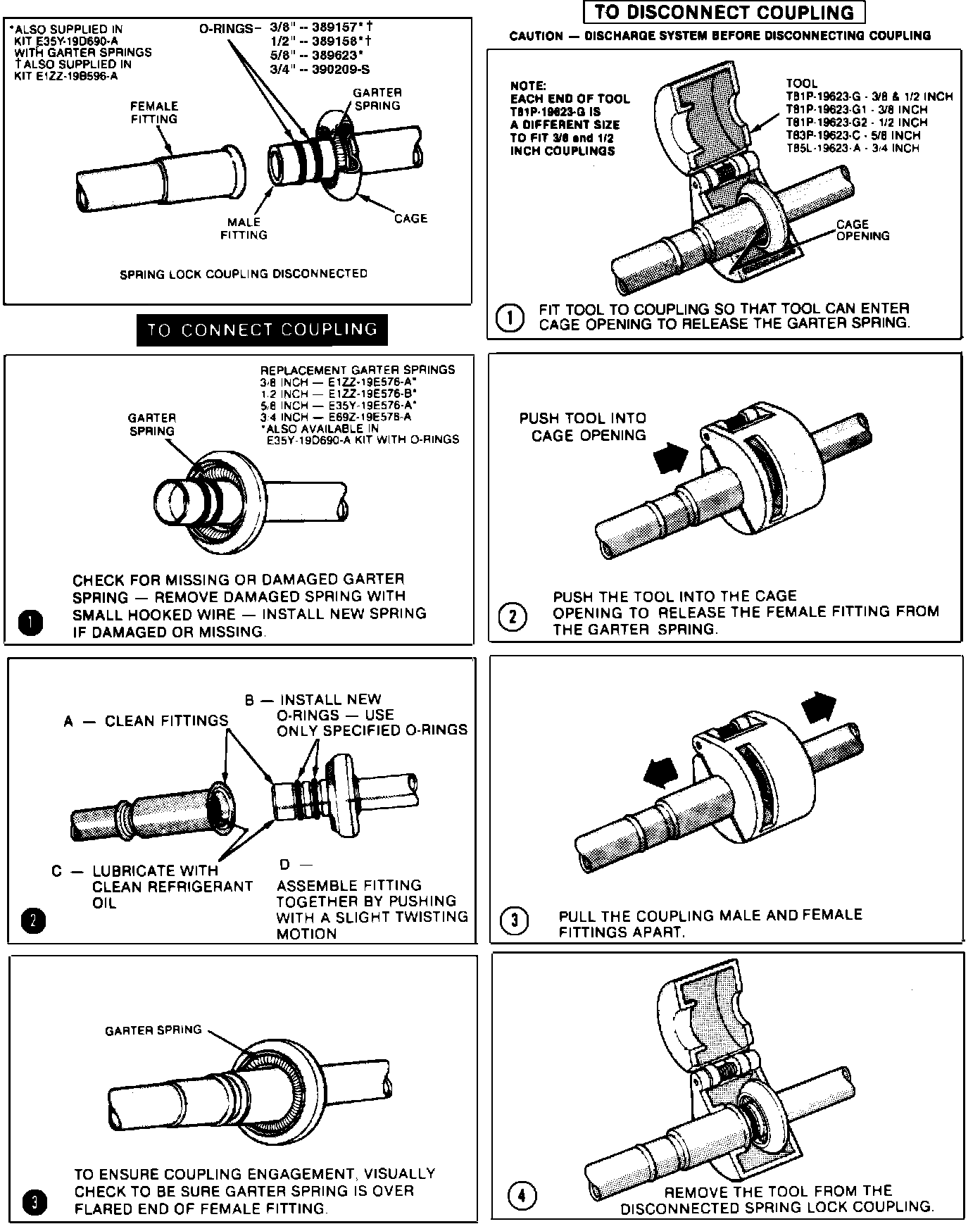

Fig. 2 Spring lock coupling disconnect & connect:

2. Remove two refrigerant lines at fittings on right side of radiator, Fig. 2.

5. Reverse procedure to install. Use new O-rings lubricated with refrigerant oil.
