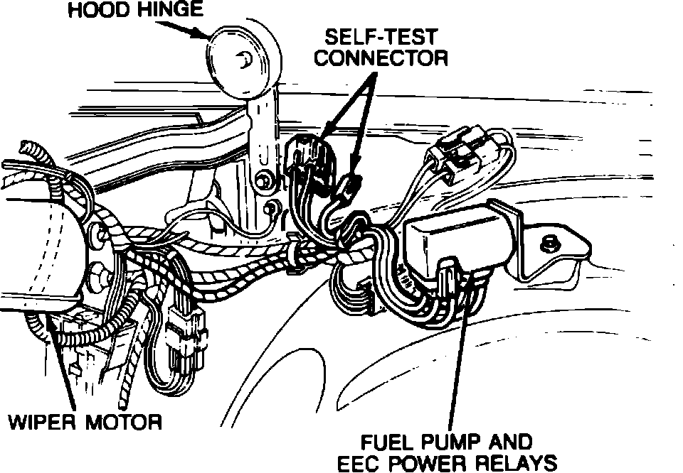

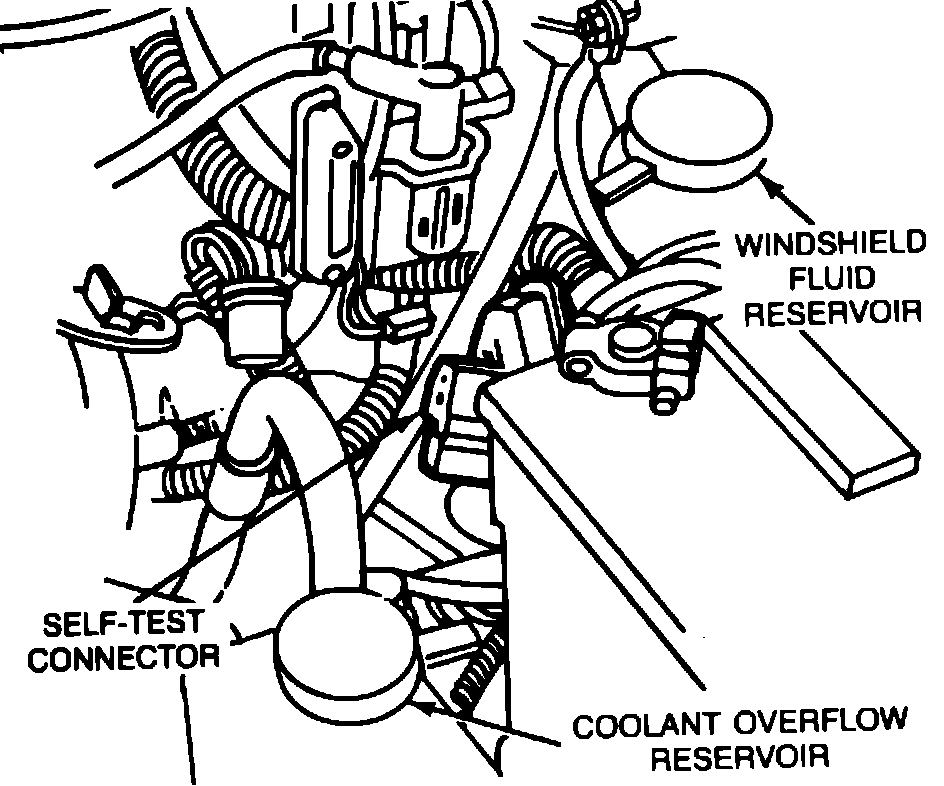

Fig. 19 Self-test connector location. Except Crown Victoria, Grand Marquis, Lincoln Town Car, Continental & Mark VII:
Self-test connector location. Continental & Mark VII:
Fig. 21 Self-test connector location. Crown Victoria, Grand Marquis & Lincoln Town Car:

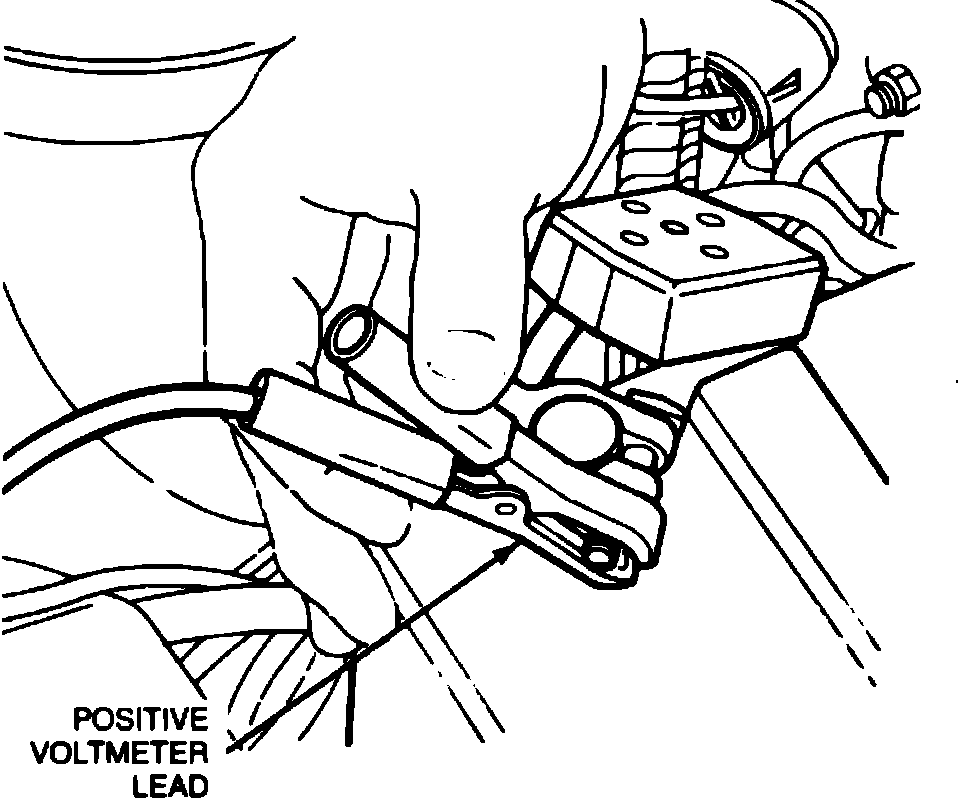

Fig. 24 Clamping positive lead from voltmeter onto positive battery terminal:
3. Clamp positive lead from voltmeter onto the positive battery terminal, Fig. 24.

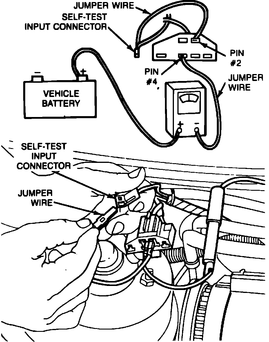

Fig. 25 Inserting 1 end of the second jumper wire into No. 2 pin on self-test connector:
4. Insert one end of the second jumper wire into No. 2 pin on self-test connector, and other end into the self-test input connector, Fig. 25. The final connection also activates the ECA self-test sequence when the ignition switch is turned to the ON position.
