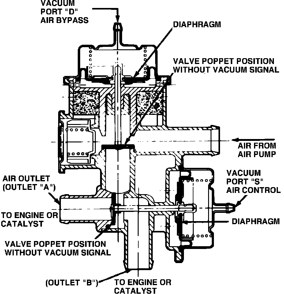

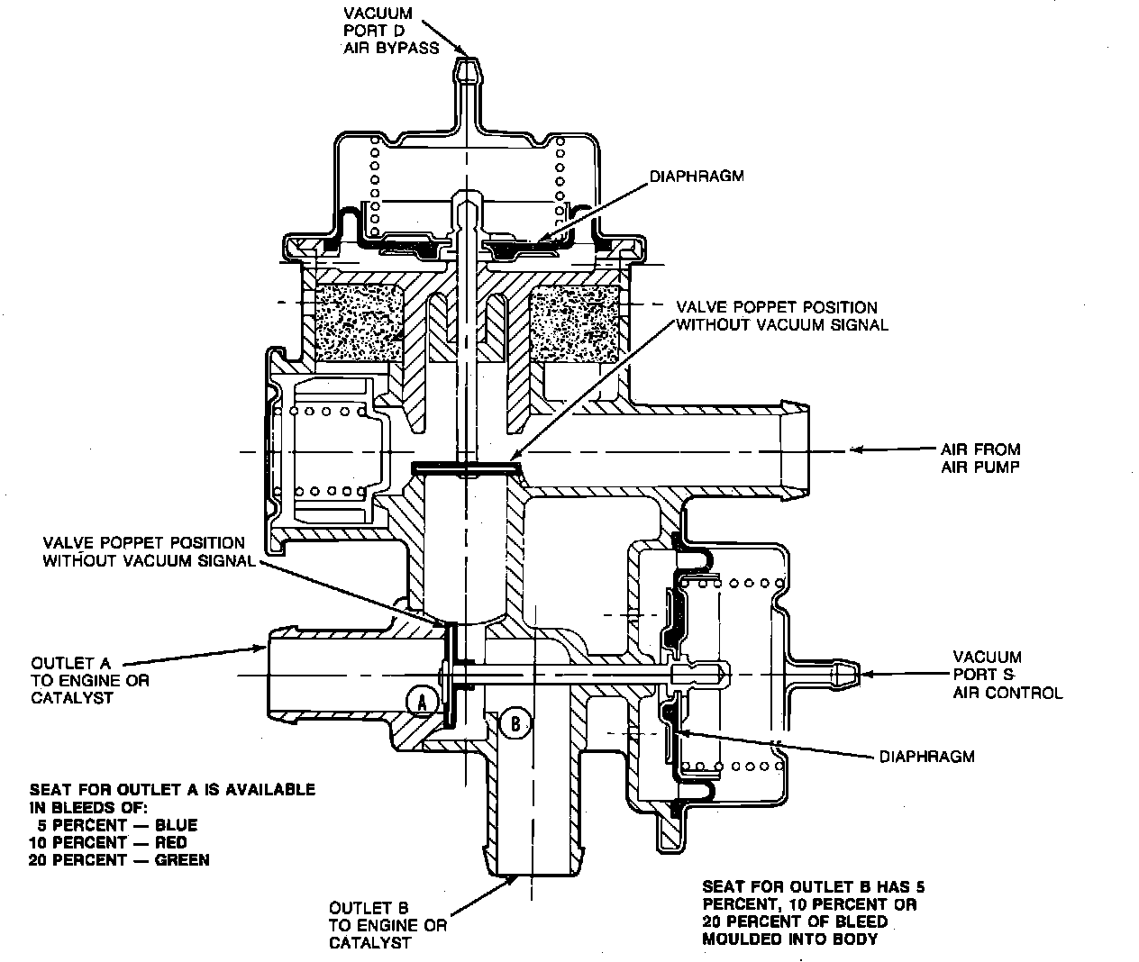

Fig. 62 Normally closed combination air bypass/air control valve less bleed:
Combination Air Bypass Valve/Air Control Valve Assembly:
Normally Closed Valves

7. On bleed type valve, some lesser amount of air will flow from outlet A or B and the main discharge will change when vacuum is applied to port S. If there is a small air tap attached to the inlet tube from the air pump, air flow should be present during engine operation.
Fig. 61 Normally open combination air bypass/air control valve less bleed:
Normally Open Valves
