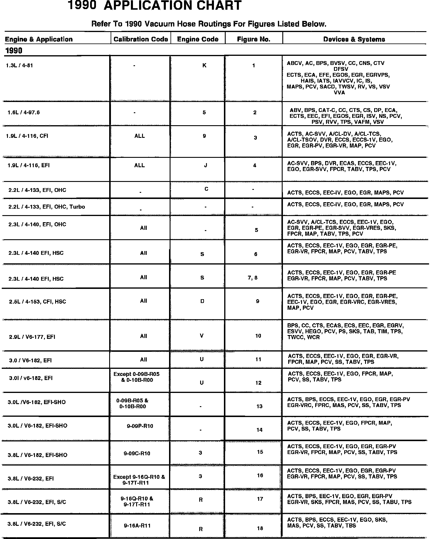

Emission System Application Chart
Emissions Application Chart:
ACTS - Air Charge Temperature Sensor
AC-SVV - Air Control Solenoid Vacuum Valve
A/CL-DV - Air Cleaner Duct & Valve Motor
A/CL-TCS - Air Cleaner Temperature Control Sensor
A/CL-TSOV - Air Cleaner Temperature Sensor Override Valve
AIR - Air Injection Reaction (Thermactor)
BPS - Barometric Pressure Sensor
DRCV - Distributor Retard Control Valve
DVR - Distributor Vacuum Restrictor
ECAS - Electronic Control Air Sensor
ECCS - Electronic Coolant Control Temperature Sensor
EEC-IV - Electronic Engine Control IV
EFI - Electronic Fuel Injection
EGO - Exhaust Gas Oxygen Sensor
EGR - Exhaust Gas Recirculation
EGR - PE-EGR Pressure External Valve
EGR - PE-EGR Pressure Valve
EGR - SVV-EGR Solenoid Vacuum Valve
EGR - VR-EGR Vacuum Regulator
EGR-VRC - EGR Vacuum Regulator Control
EGR-VRES - EGR Vacuum Reservoir
FPCR - Fuel Pressure Charging Regulator
MAP - Manifold Absolute Pressure Sensor
MAS - Mass Airflow Sensor
PCV - Positive Crankcase Ventilation
TABV - Throttle Air Bypass Valve
TBCPR - Turbocharger Boost Control Pressure Regulator
TPS - Throttle Position Sensor
