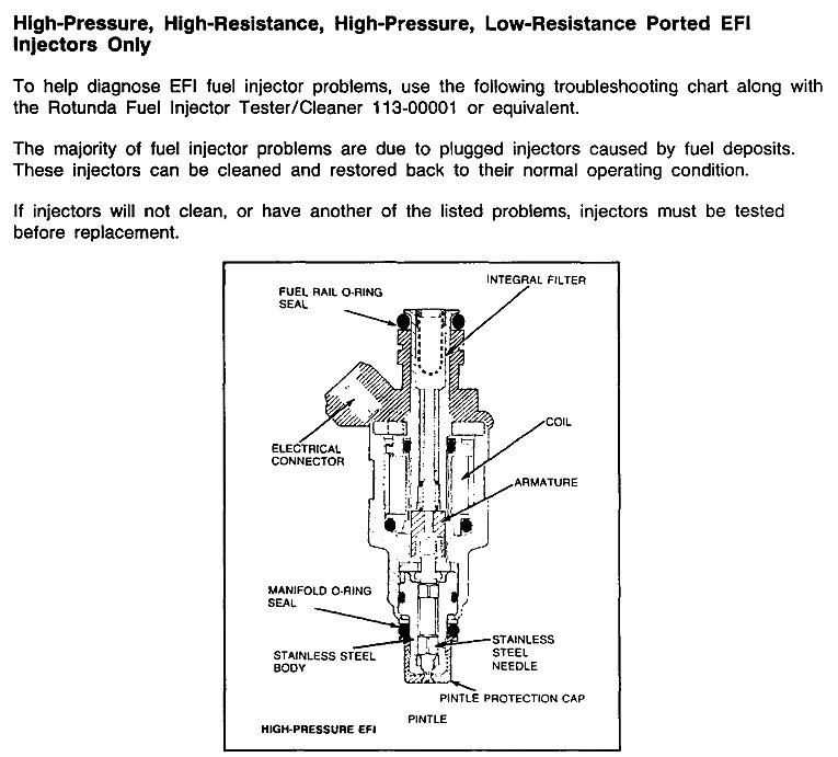

Fuel Injector: Testing and Inspection
Fuel Injector Testing

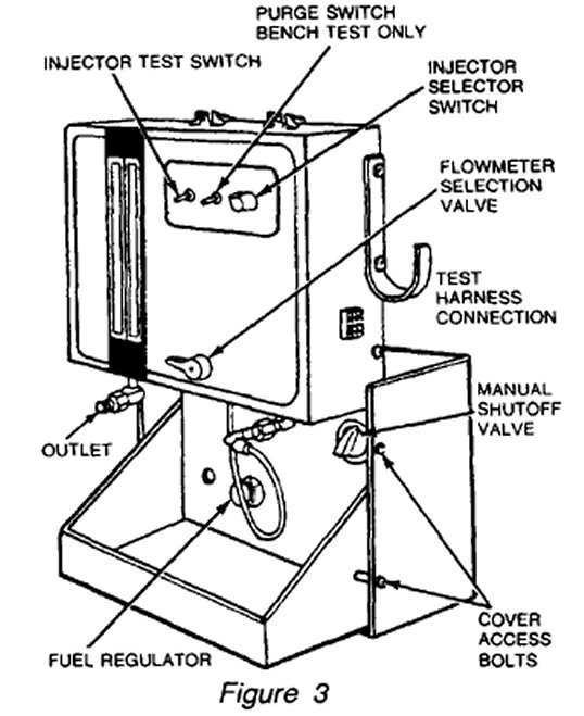

1. Turn manual shutoff valve (Figure 3) of test stand panel to OFF (closed) position.
2. Filter (use paint-type filter) and pour clean gasoline into the tester fuel tank, and fill to lower fill line for 8 cylinder vehicles, use less for 4 and 6 cylinder vehicles.
DO NOT ADD ANY CLEANER SOLVENT IN TANK FOR TESTING.

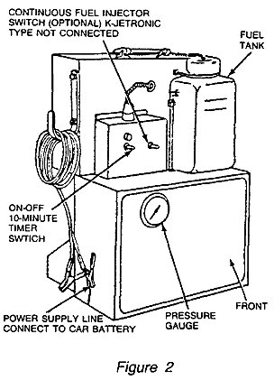

3. Connect power supply line (Figure 2) to vehicle battery (red terminal, positive; black terminal, negative). Red light (on cleaner side) will flash indicating power connection has been made and the unit is off.
4. Activate the 10 minute timer switch, check pressure gauge. The gauge should read 38-40 psi. If adjustment is necessary, turn shutoff valve to ON (open) position, for resetting of regulator (refer to Figure 3). Remove black cap, back-off locknut, turn screw to obtain proper setting and retighten lock nut. Replace cap. Turn unit off.
5. Connect fuel supply hose to outlet (Figure 3) and place other end of hose back into tank. Actuate the 10 minute timer switch and turn flowmeter selection valve to flowmeter No. 1 and then to flowmeter No.2. Repeat this procedure several times to eliminate all air bubbles from the system. Turn unit off. Flowmeter selection valve must be in position No. 1 or No. 2 for unit to function properly. Reinstall fuel tank cap snugly and back-off one turn.

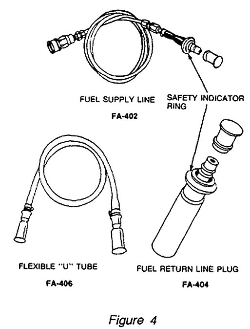

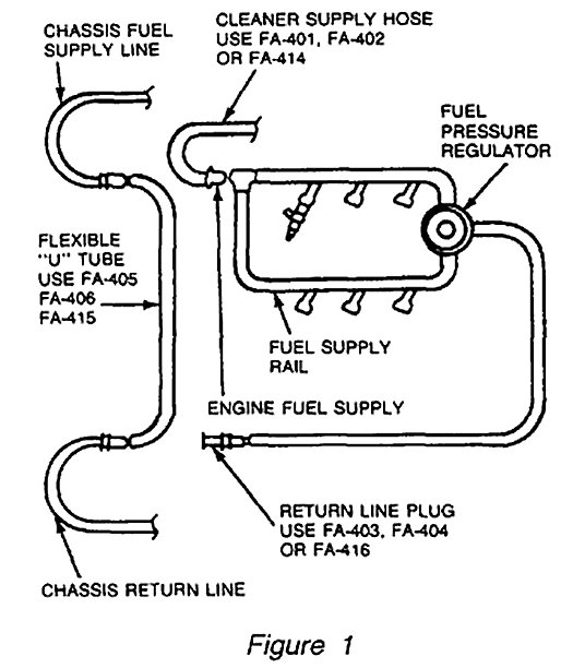

6. Disconnect engine fuel inlet connection at the fuel manifold (rail). Connect the supply hose from testing equipment to the fuel inlet connection (Figure 1).
7. Disconnect engine fuel return connection at the fuel manifold (rail) from fuel return. Plug the return line as shown in Figure 1. Install the U-Tube (supplied) between the chassis supply line and the chassis return line (Figure 1).

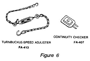

8. Install the tunbuckle (Figure 6) loosely between throttle control rod and suitable hook-up point on vehicle fender wall. Activate the 10 minute timer switch.

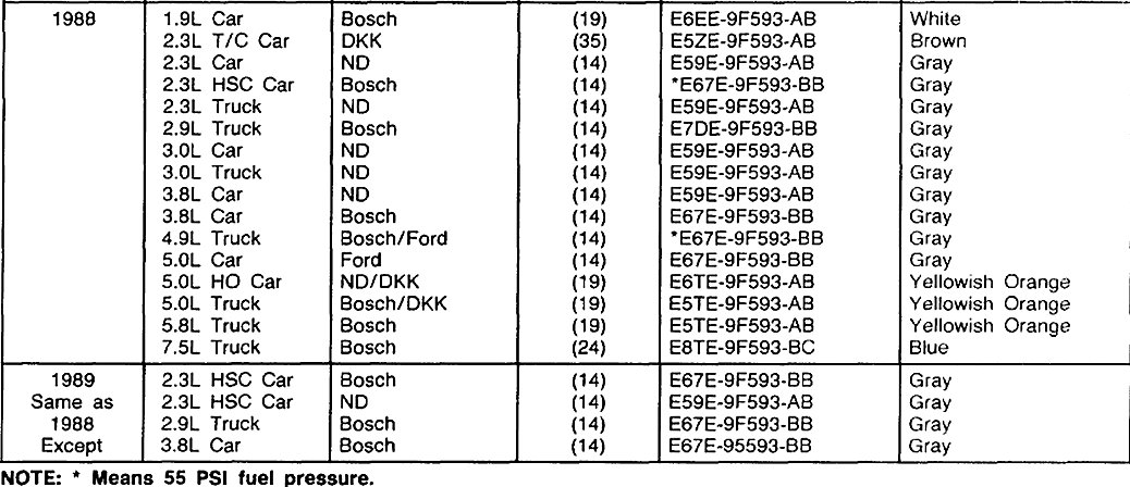

10. Select the proper flow range. Turn the flowmeter selection valve to
Flowmeter No.1 for Blue, Grey or Yellow injectors, or
Flowmeter No.2 for White, Black, Green or Brown injectors.
The flow band colors correspond to the injector top color (Color may vary slightly between manufacturers.)
Refer to EFI Application Chart.

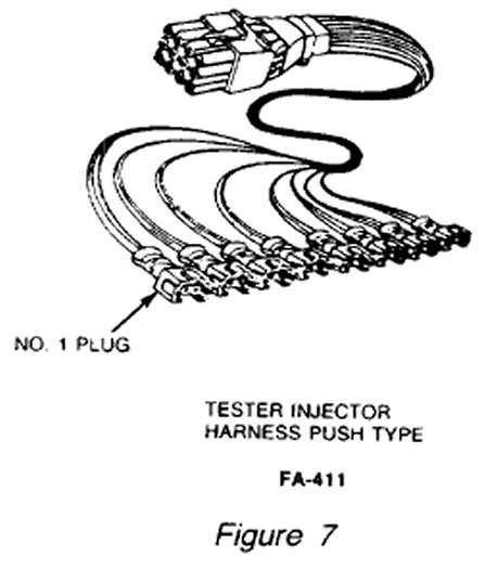

11. Install the tester injector harness (Figure 7) on the vehicle injectors. Match the injector number on the harness to that of the cylinder (or use 10 pin connector FA-41 2, Figure 8) for 5.OL engine (or 8 pin adaptor harness No.6222 for 3.8L).
12. Position injector selector switch to each injector number while pressing fuel injector test button.
13. Observe the position of the flowmeter float at eye level when the ball stops rising. A float level within the color code range on the scale indicates a good injector.

15. Any injectors removed from an engine should be bench tested to confirm diagnostic conclusions. A continuity checker FA~407 (Figure 6) is provided to check continuity of injector harness leads between the injector and the ECM unit. Disconnect injector and insert continuity checker FR-407 into injector plug. Start engine. Observe. Continuity checker will blink showing completed circuit for that injector being tested.

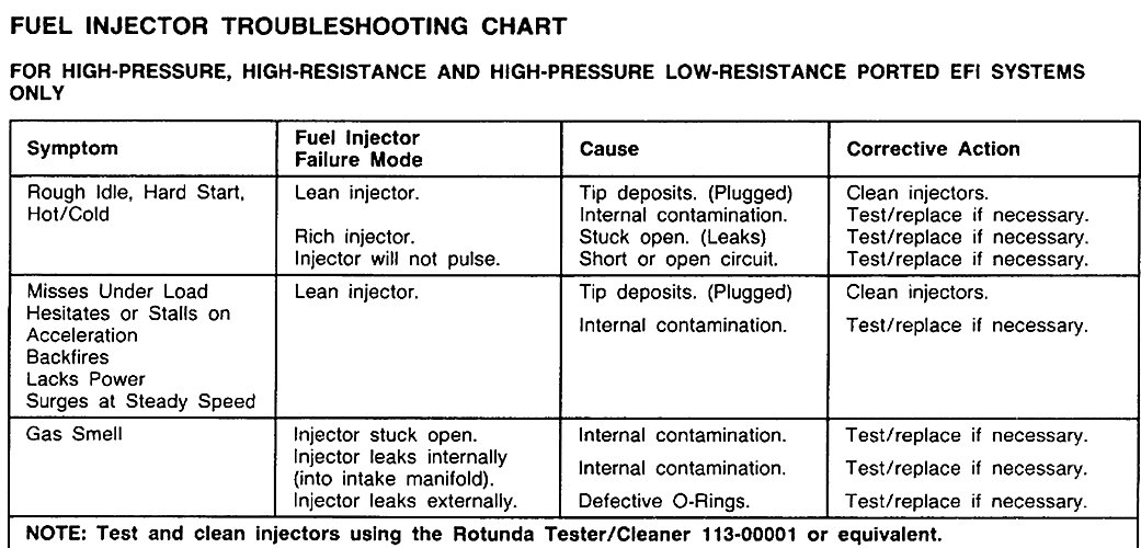

a. If the flowmeter readings are high or low on the color code scale, the fuel injectors should be cleaned.
b. If all the readings are high, there may be leaky injectors (one or more). To check for leaky injectors, observe pressure gauge. It should hold pressure with the fuel pump off. If there is a pressure drop, detect the leaky injector by observing flowmeter (the leaky injector shows less flow). If this is not possible, remove all injectors and test individually. Refer to Bench Testing procedure.
c. If fuel injector cleaner is required, turn manual shutoff valve to the ON position. Refer to fuel Injector Cleaning Procedure.

1. Check that the manual shutoff valve (Figure 3) at the back of test stand is in ON (open) position.

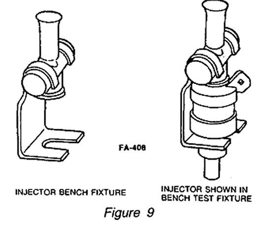

3. Connect the fuel supply hose FA-402 (Figure 4) to the fuel supply outlet (Figure 3) and to the Bench Fixture (Figure 9).
4. Insert injector to be tested in Bench Fixture as shown in Figure 9.
5. Connect the No. 1 tester harness connector (Figure 7) to the fuel injector. Turn the injector selector switch (Figure 3) to No. 1 position.
6. Direct the injector nozzle into the tester fuel tank.
7. Connect the power supply leads (Fig. 2) to the battery, observing correct polarity.
8. Activate the 10 minute timer switch and check for leaks.
9. Press the injector test switch (Figure 3) and the purge switch together for about 30 seconds to eliminate air from the supply hose and injector.
10. No leakage from the fuel injector nozzle tip should be visible. Replace any leaking injector.
11. Press injector test switch (Figure 3) to test injector, observe float in flowmeter
12. Check the flowmeter readings and record all test results.
