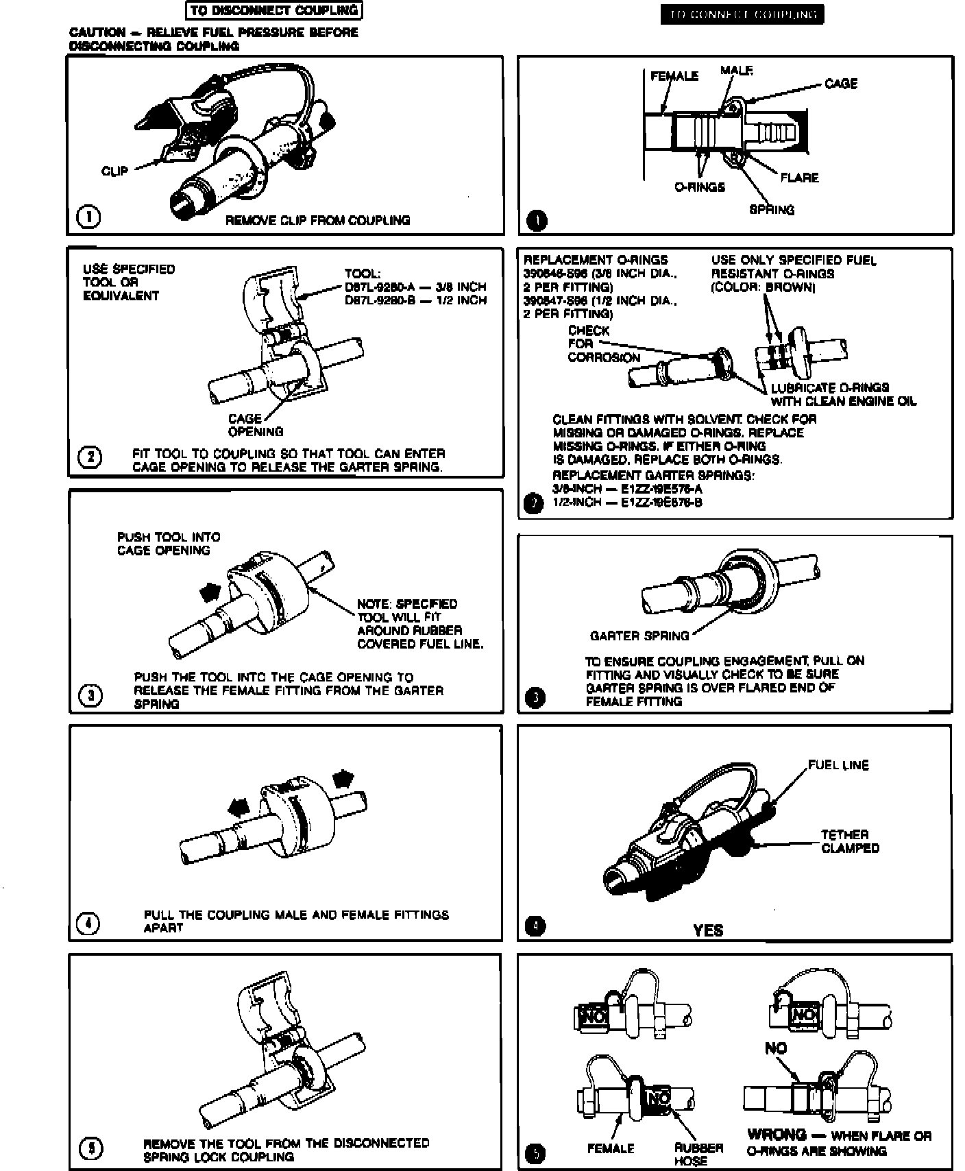

SPRING LOCK COUPLINGFuel Line Couplings:
REMOVAL
1. Relieve fuel system pressure, refer to MAINTENANCE PROCEDURES/FUEL SYSTEM PRESSURE RELIEF.
2. Disconnect the negative battery cable.
3. Remove retaining clip from the spring-lock coupling by hand only. DO NOT use any sharp tool or screwdriver as it may damage the spring lock coupling.
4. Twist fitting to free it from any adhesion at the O-ring seals.
5. Fit Spring-Lock Coupling Tool D87L-9280-A (3/8 inch) or D87L-9280B (1/2 inch) or equivalent to coupling.
6. Close tool and push into open side of cage to expand garter spring and release female fitting.
7. After garter spring is expanded, pull fittings apart.
8. Remove tool from disconnected coupling.
INSTALLATION
1. Ensure garter spring is in cage of male fitting. If garter spring is missing, install a new spring by pushing it into cage opening. If carter spring is damaged, remove it from cage with a small wire hook (do not use a screwdriver) and install a new spring.
2. Clean all dirt or foreign material from both pieces of coupling.
3. Replace missing or damaged O-rings.
CAUTION: Use only the specified O-rings as they are made of a special material. The use of any O-ring other than specified may allow the connection to leak intermittently during vehicle operation.
Lubricate male fitting and O-rings and inside of female fitting with clean engine oil.
4. Fit female fitting to male fitting and push until garter spring snaps over flared end of female fitting.
5. Ensure coupling engagement by pulling on fitting and visually checking to ensure garter spring is over flared end of female fitting.
6. Position retaining clip over metal portion of spring lock coupling. Firmly push retaining clip onto spring-lock coupling. Ensure horseshoe portion of clip is over the coupling. DO NOT install retaining clip over rubber fuel line.
NOTE: Install the large "black" clip to the supply side fuel line and the smaller "gray" clip to the return side fuel line.
