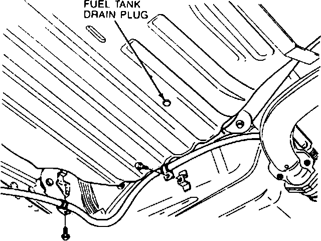

Fuel Tank Drain Plug:
7. Raise the vehicle and support it with safety stands.
8. Remove the drain plug and drain the fuel from the fuel tank into an approved safety container.

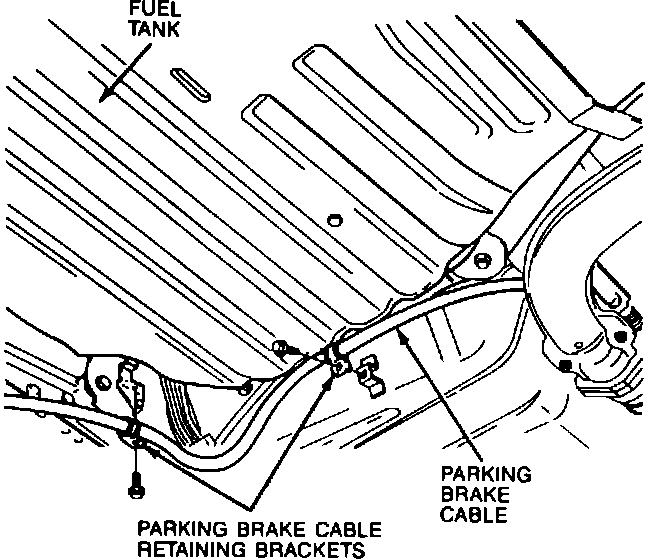

Parking Brake Cable Retaining Brackets:
9. Remove three clamps and vapor hoses at the fuel tank filler neck assembly.
10. Remove the clamp and fuel tank filler neck hose at the filler neck assembly.
11. Remove two parking brake cable retaining brackets from the chassis to gain access to the fuel tank.

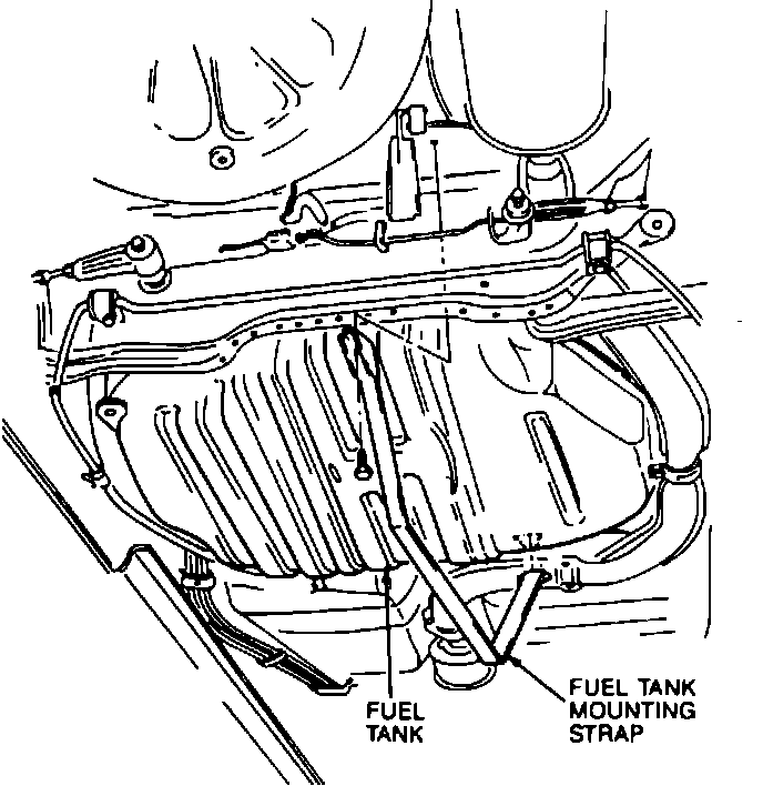

Fuel Tank Mounting Strap:
12. Remove the fuel tank mounting strap.
13. Support the fuel tank and remove the three attaching bolts and brackets.
