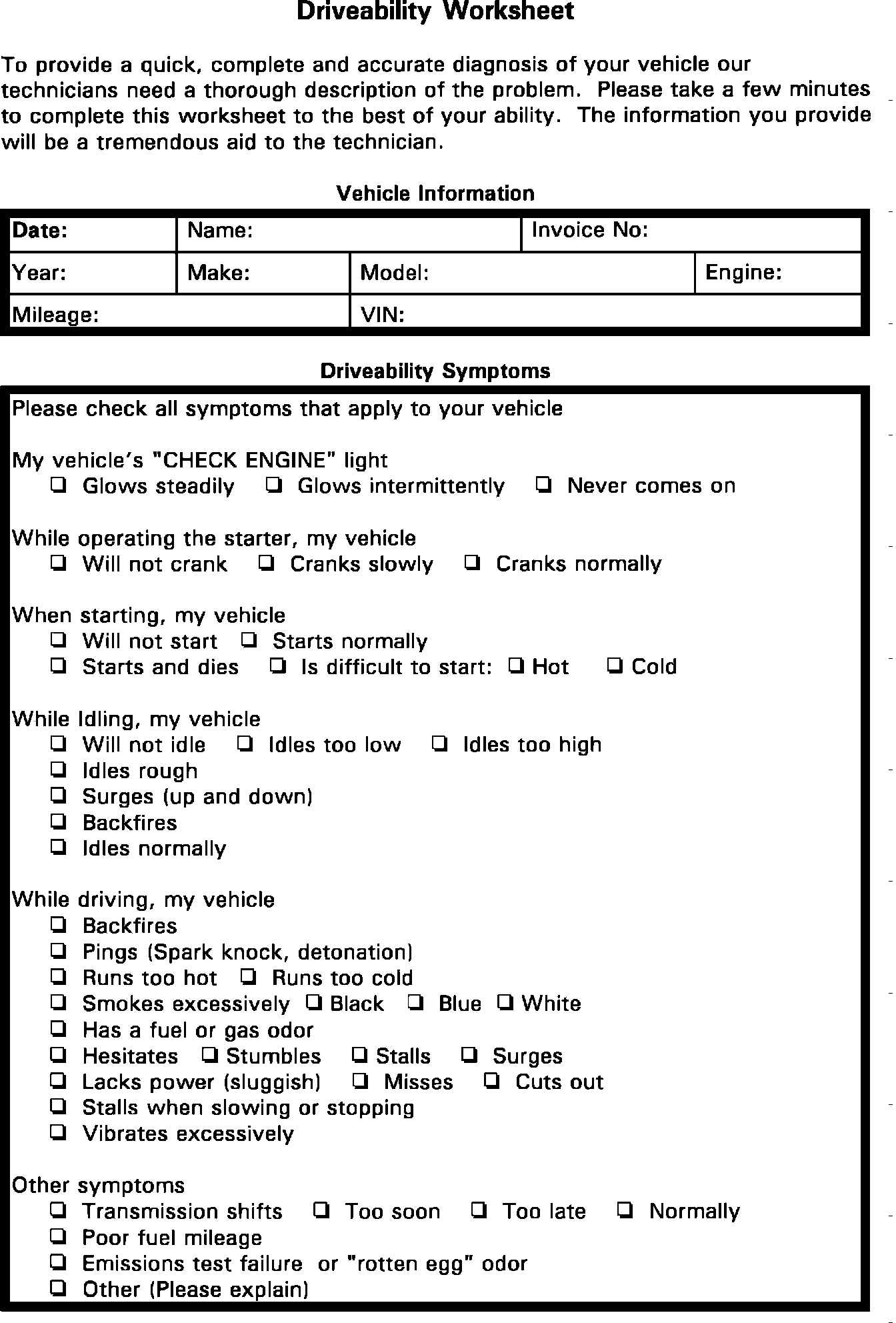

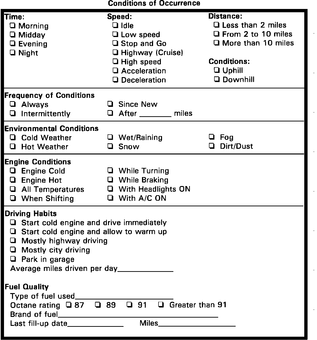

Driveability Worksheet:
DRIVEABILITY WORKSHEET

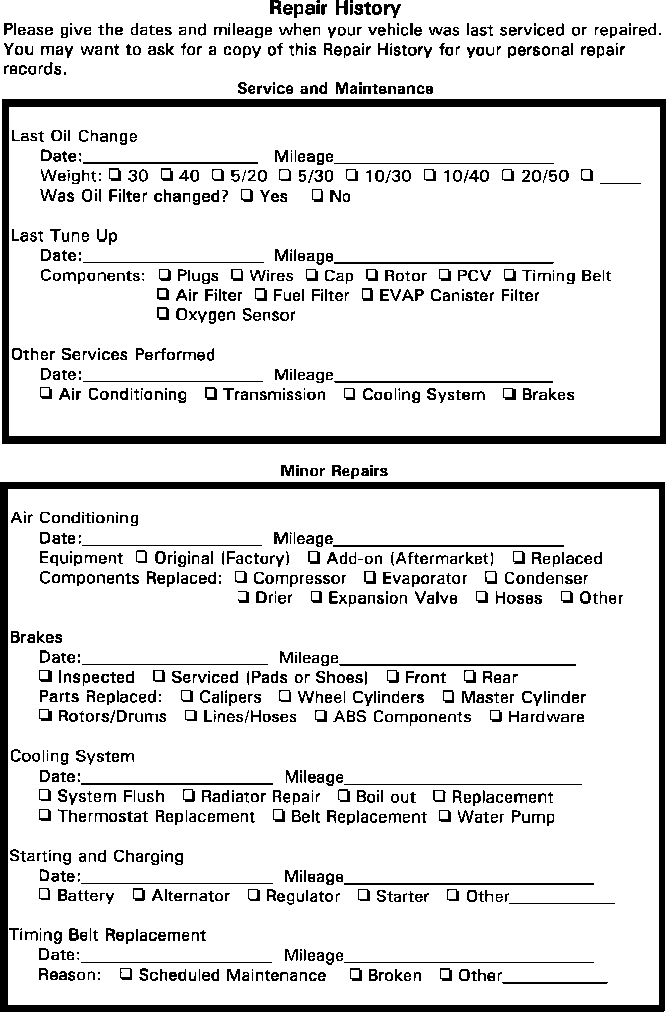

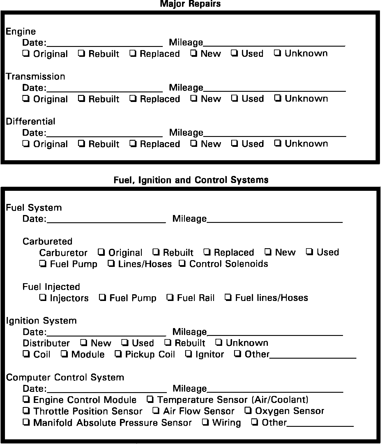

Vehicle Repair History:
VEHICLE REPAIR HISTORY
