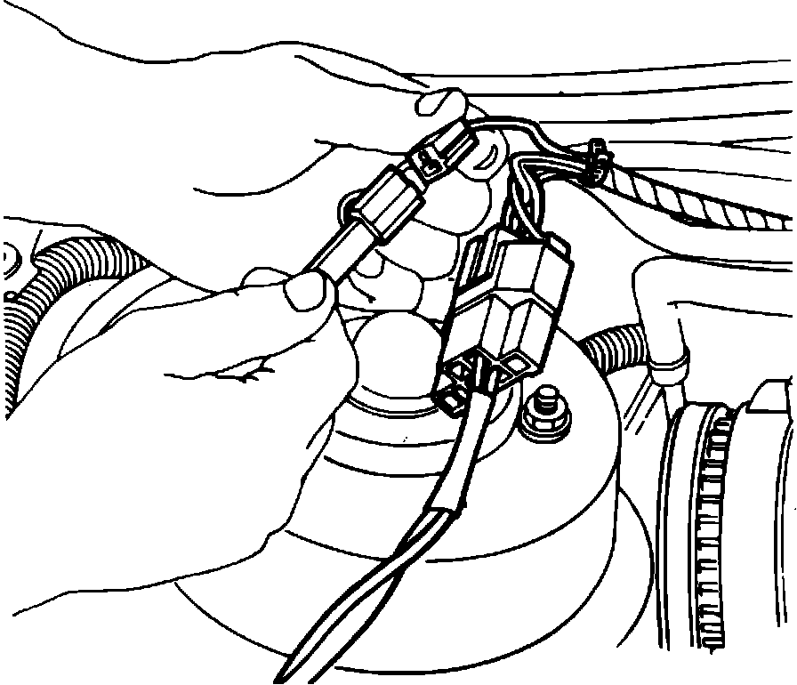

The self-test connector and tester hook-up is identical on all models. A two-piece self-test connector on the vehicle, plugs into a matching two-piece service connector at the end of the STAR/Self-Test adapter cable assembly. To connect the STAR tester proceed as follows:
1. Turn ignition switch to OFF position.
Self-test connectors:
2. Connect the color-coded adapter cable leads onto the STAR tester.
3. Connect the adapter cables two service connectors to the matching self-test connectors on the vehicle.
